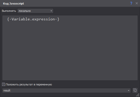

3. And finally using JavaScript action calculate the result:
66122

Thank you for this answer, I had no idea I could do it this way :-) There's one problem though - JavaScript block says this:
Errors: - Macro {Variable. is usedcaptchatext-}. Macros cannot be used in C# code. (screenshot attached) and while it works in Project Maker, ZennoPoster seems to ignore this block, probably due to this error :(
Try project from attach. I've checked both PM and ZP, it works great.
