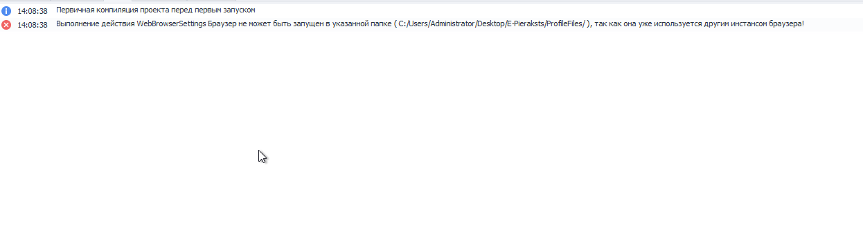

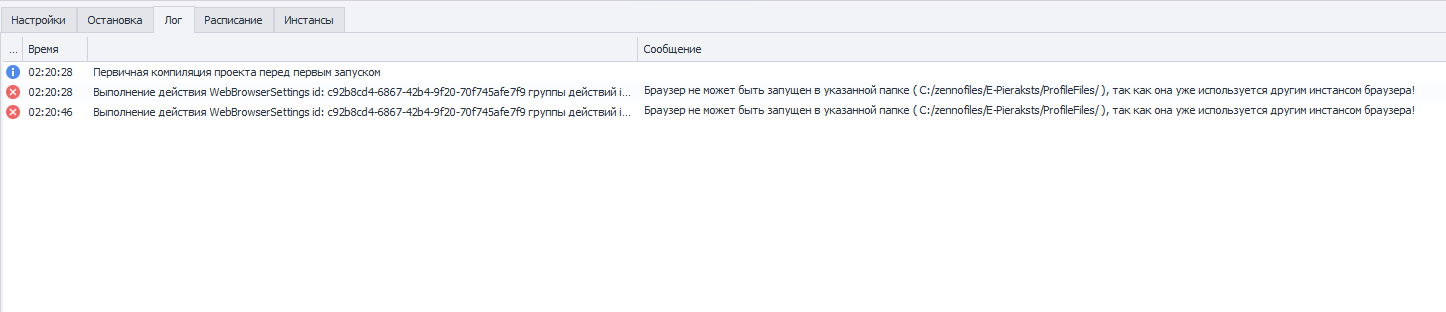

Lets move to new thread if this is not related, but right now I can still see its not really possible to run in zenno after you edit in PM.
119369
What i do is, run template and then after running i try to Run instance without a browser. But this still does not help, as you see in the image. Basically, only closing Project maker helps to unbind profile folder. This is from the latest version 7.11
Same is if i work only in PM, I end my template and wanna rename profile folder. But I can't really do that, as there is still this same error.
22 810
6 037
To unbind profile-folder in PM, you should run instance with browser without folder. I think it works like this.
