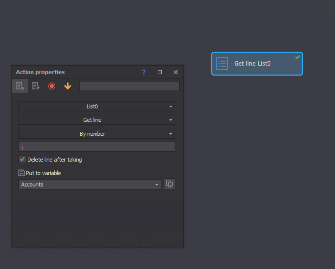

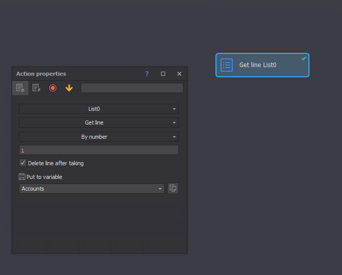

I'm sorry for asking so many questions, but how do I get them one by one from the list to variable?
The only way I could do it is if I delete the next line, but I need to run the bot every 30 minutes, endless times.
So if I delete the next line, the list wont have anything in the second running of the bot.

You should get line with deleting, then add line to the end of the list by next step.
Or you can add it in the end of your project whet it's completed.
Thus, every thread will be getting next account.

I did that and it worked perfectly.

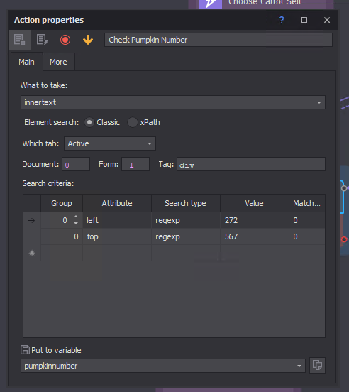

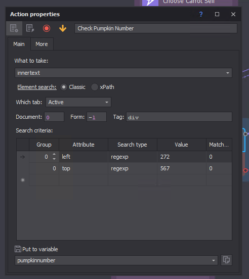

I have one more question though, I'm trying to get the value of innertext for a box, and I'm adding its left & top attribute.
But the top and left keep changing because instances run with random screen resolution (I think, I am not sure)
I tried adding this C# code :
instance.SetScreenPreference("OuterWidth", 1366);
instance.SetScreenPreference("OuterHeight", 768);
instance.SetWindowSize(1366, 768);
instance.SetWindowPreference(ZennoLab.InterfacesLibrary.Enums.Browser.WindowPreference.InnerHeight, 1366);
instance.SetWindowPreference(ZennoLab.InterfacesLibrary.Enums.Browser.WindowPreference.InnerWidth, 768);

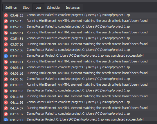

But still zennoposter sometimes finds the element and sometimes it doesn't.
Is there a way to make it work more consistently so it can always find the top & left attributes of the element?

You should search the element by another attributes - id, name. class, not coordinates which changes every time.
you can also even try xpath

I tried Xpath, id, name, class, literally every other attribute, all the boxes have the same attributes and the match # is always changing, so coordinates is my only option.
Is there anyway to make the coordinates consistent using zennoposter?
