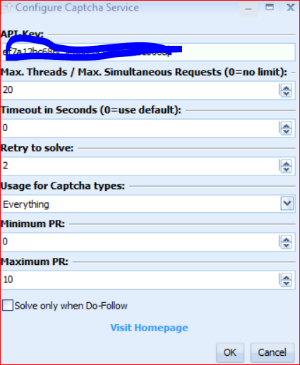

Using GSA SER. I have the Cloud API in the Captcha setup. Where would I enter this “{apikey} __ mailru”? And would that just solve that captcha?
22 829
6 040
UnkleFrank
19.10.2020
12
Here's a screenshot of the Captcha setup for Cloud
22 829
6 040
UnkleFrank
19.10.2020
12
OK. Thanks.

Hi Vlad
I've used every combination of options to connect my API key to the Cloud version. I've tried double quotes at the beginning and the end. Brackets around the API key and a combination of both. I'm using GSA SER and when trying to test I get an IP Banned message.
Examples:
API Key_universal
"API Key_universal"
{API Key}_universal
"{API Key}_universal"
All fail.
Any suggestions?
Thanks,
Frank

Hi Frank,
There is no need in any brackets.
Just put your apikey number and universal module into captcha config in GSA SER
00f87cb0f01330d33709ce3339ad0c8c__universal
ERROR_IP_BANNEDYou have exceeded the limit of requests with the wrong api key, check the correctness of your api key in the control panel and after some time, try again
So, wait a little and try again.

Vlad
Tried exactly what you have; my apikey_universal.
I get this message:
Account authorization key not found in the system or has incorrect format.
Looking closer at your code I see you have two underscores. This works. Might be a good idea to let people know there are two there...?

There are 2 underscores in example in help docs - https://zennolab.atlassian.net/wiki/spaces/APIS/pages/187269121/How+to+pass+module+name+to+CapMonster+Cloud+using+ApiKey+field+only
