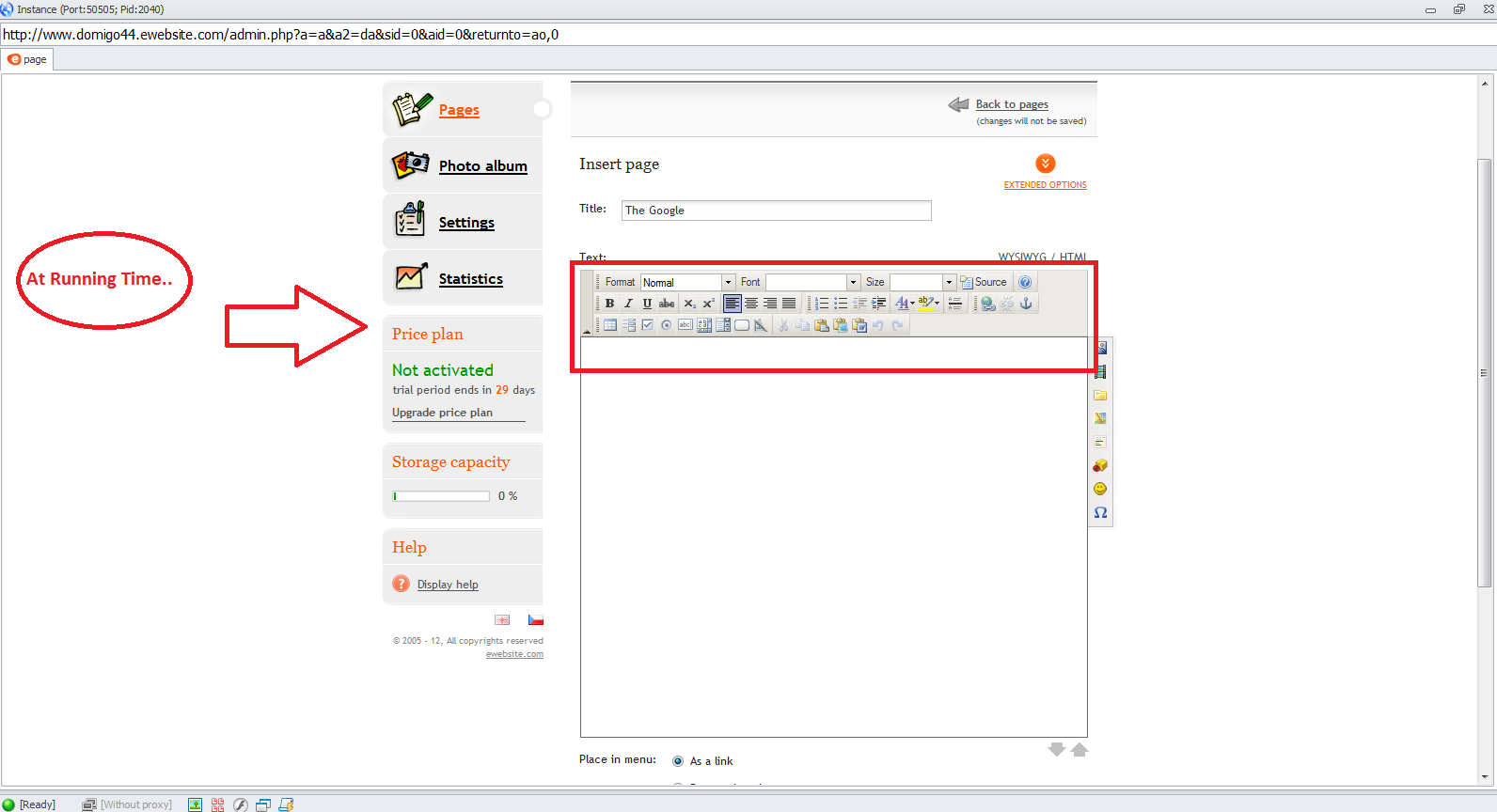

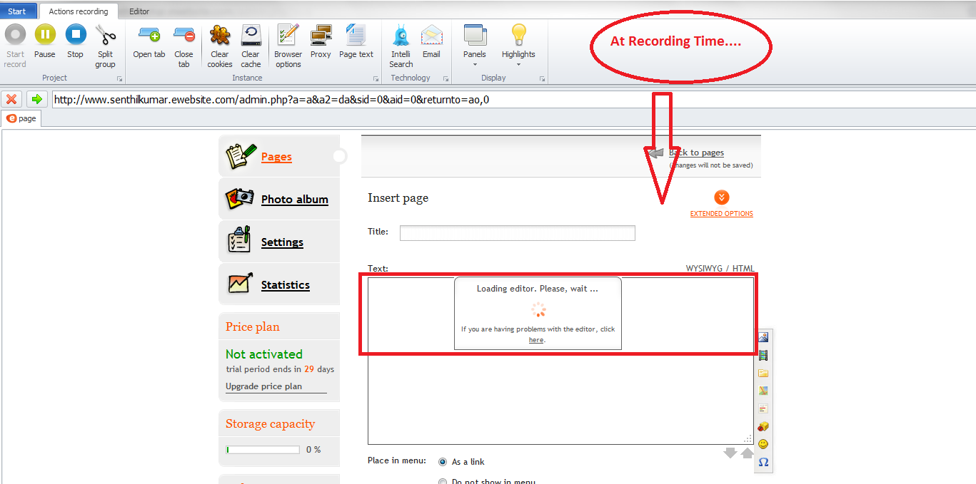

Hi there,
I have created template for http://www.ewebsite.com..this site template creation at the time of the recording this type of content body displays Screen Shot Here..@ Recording Time.png
At the time of the Running this type of the content body displays screen shot here...@ Running Time.png
i got error..! "html element not found by search criteria" how can i solve this issue..

Thanks for your Response.:-) But i already tried this...when we use the Java Script as Disabled at the time of the recording time the loading editor popup ..loads..long.....long..time..that did't not stopping..see here..the loading editor popup window (Green Color Marked)..@ Recording Time.png..
Any other options please..!:confused::o

Your Right HB..:-) when at the time of execution the post content body will not displays "WYSIWYG Toolbox" your option is right to use user agent...But my problem is at the time of the recording the "WYSIWYG Toolbox" Post content body not display only at the time of execution the "WYSIWYG Toolbox" post content body displays..!!!
So how can i record with the WYSIWYG body at recording..!:o
Any more options please..!:(

So when you are recording, the WYSIWYG isn't displayed. If so then use firebug in firefox to get proper data. i think you just need to click on HTML button. You can try search by picture button instead.

I have created template for http://www.ewebsite.com..this site template creation at the time of the recording this type of content body displays Screen Shot Here..Посмотреть вложение 1818
At the time of the Running this type of the content body displays screen shot here...Посмотреть вложение 1822
