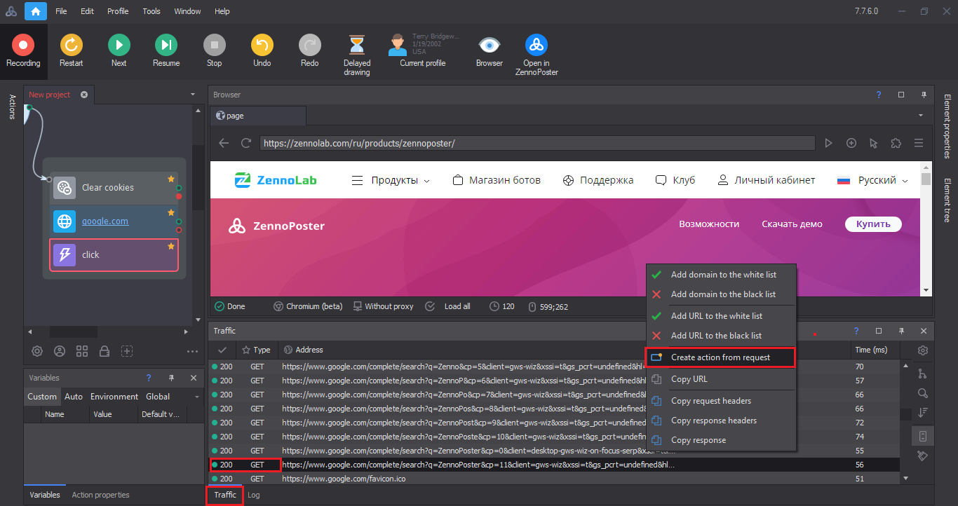

There is no so much to tell you actually.
You should work with target website in browser in ProjectMaker, monitor http requests which sent during your work in browser and make actions from related requests.
