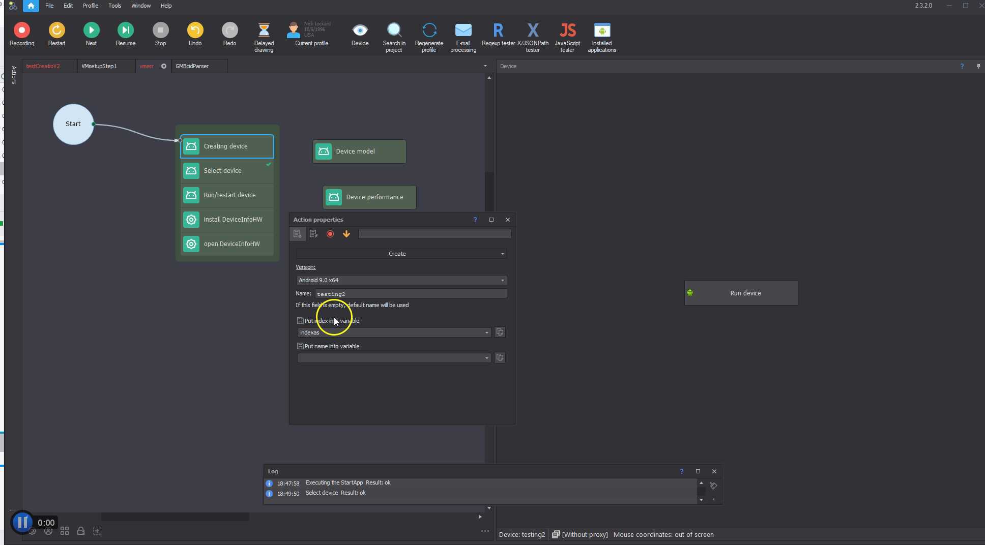

Did more tests without 'apply profile settings on startup'
It turns out that any modification on VM , like changing CPU/RAM , wifi name etc. will mess everything up.
Create VM > select it > modify CPU/RAM > start = device details corrupted, this can't be expected behaviour.

you should check Apply current profile option when running VM

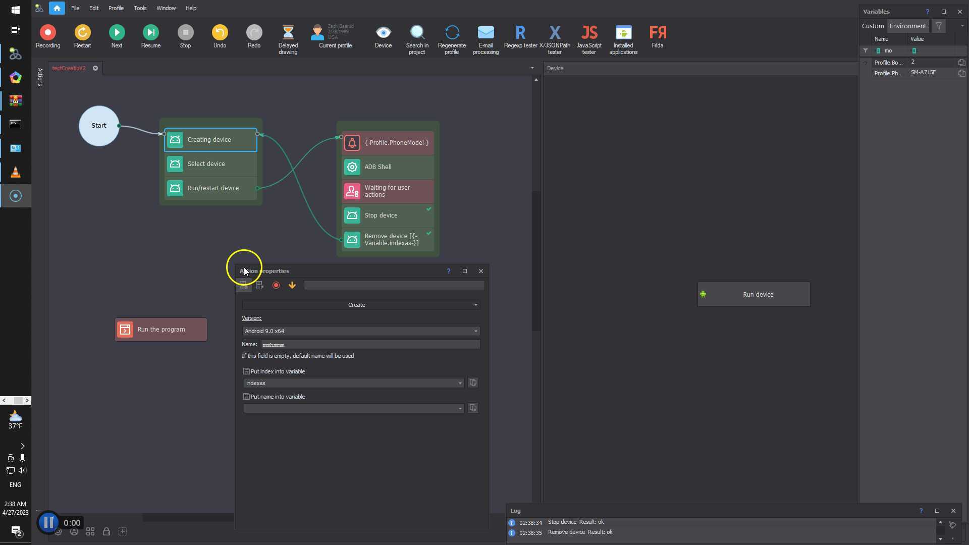

It is 100% a bug, and a very very serious one, please have a look at the video - https://somup.com/c0ftl44Caf
First run we create new VM, modify device model - device gets corrupted
Second run - Only create and run it - device is correct (random memu device)
Really not sure :bc:

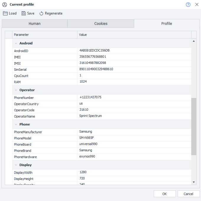

Don't fully understand what you are doing...
You should modify device model in profile, then apply this profile when running VM.
That's how it works.

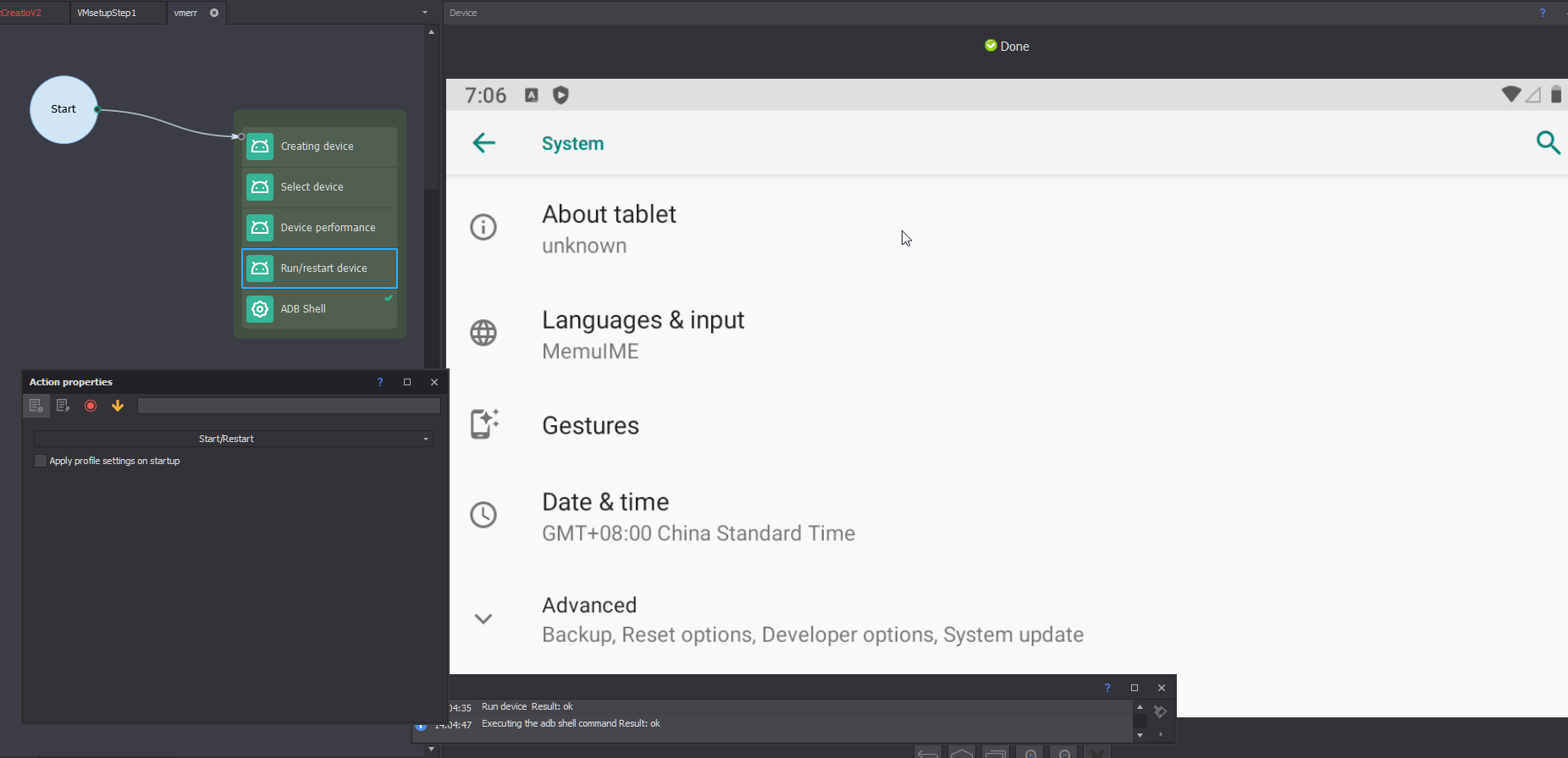

The device simply gets corrupted if you enable the 'apply profile settings on startup' or do any other modification to it through zenno
I am really not doing anything else, only:
Create device > Select > Start (apply profile settings on startup enabled) = device gets corrupted
Went through all the memu and zp logs, can't find anything...
Attaching the template with these 3 steps, could you please run it to confirm that it is not messing up on your side?

We've made a reasearch and found out that this is the bug in Android 9 image.
You should set 4 cpu cores in Device settings>Performance>Processors.
With 1 processor it does not work and always generates unknown.

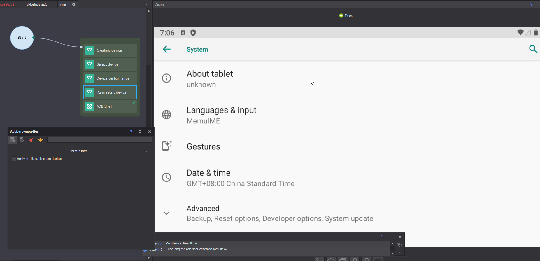

Thank you for taking the time to investigate this, I appreciate it.
Working now with 4 CPUs, although it is a bit unfortunate because it would need more resources to run many threads, let's hope there's a solution to have it with 1 CPU.
Although I think there's something more to it, because now with 4 CPUs I am still getting about 30% of 'unknown' devices, so it is about some combination of parameters that mess things up, I will run more tests and update this.

Hi,
Please try using new test version of ZennoDroid. We tried to solve the issue generating unknown parameters in it.
Tell us about the results.
