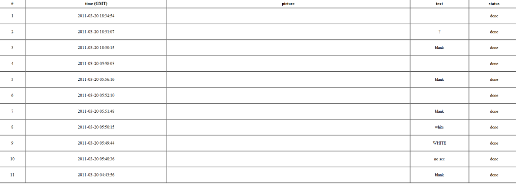

Hi, I bought ZP Standard a couple days ago and since then couldn't make the decaptcher to work. On one site the captcha returns just the word "BLANK" and on the decaptcher site, under statistics, where usually you can view the latest submitted captchas there's this
On another site I get the following as a return
Unable to cast object of type 'DeCaptcher.DeCaptcherResult' to type 'interfaceslibrary.ICommonInterface'.
and it doesn't show that it even reached the decaptcher under their stats.
