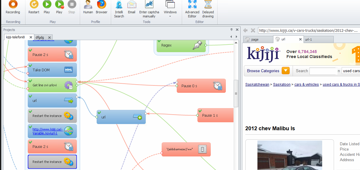

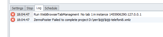

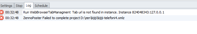

two days i try found mistake in template. In PM, all is fine, but in ZP not. I have one template without end, but one execution. And allways stop after 10 minutes.
ZP can not find tab url, but in PM can .I put pause, but still is error.
Second error is some regex, i mean, if not find regex, in PM all is ok, go further ... I do not know how to solve this, becouse in PM can not simulate error.

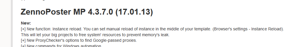

You need to reload the instance, if your template is In the loop. set a number and do reload instance 5-6 times every time.

Is this browser option- restart the instance ?
This is for memory leak problem?
I found this description :

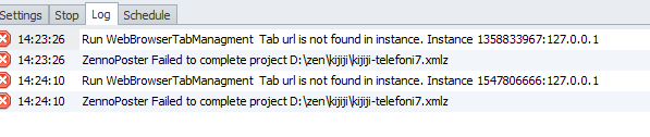

Same, in template , in several places, i open page and tab 1, in PM works fine, but now again show me this error with instance and tab I put on 6 places restart instance, but this is not i thing problem, becouse on start in first 1-10 minutes show me this error and template stop
In PM, template work a hours, without any problem, but in ZP, after some minutes this error
29 068
5 725
after instace restart you need to open tabs again

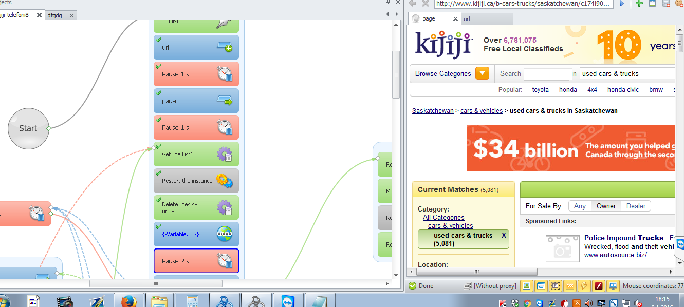

I now again open url page before activate url tab. This mean in PM, open url-1, but this is ok, if in ZP url tab gone, all will be fine, if is it problem .
Yes now should be ok., but you have puted, two instance restart, and it is not right too, because you are doing a restart by once, and you do restart same time again. Also i can`t say the second restart is right or not, because on the picture it not shown, what action goes after restart instance.

ProjectMaker cannot restart instance. That's why you see all old tabs open.
This action works in ZP only
