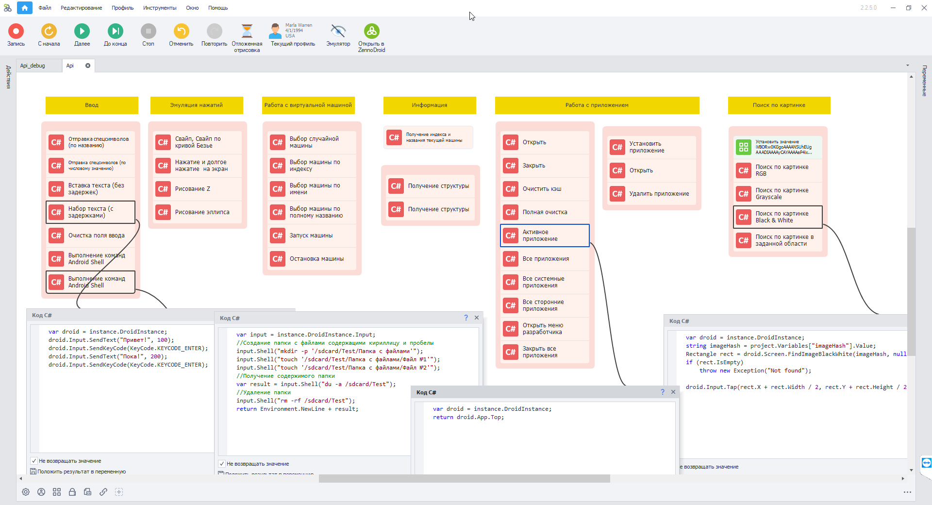

С# API в процессе разработки. Скинул примеры в тикете.

Also looking for more example how to click on elements by xpath or other alternatives, clicking by image/text is very inconvenient.
