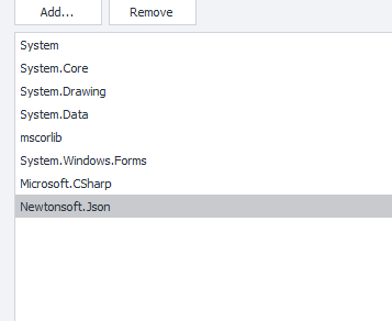

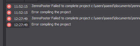

hi there
i have added an external c# library to my project and it works fine in project maker and also in zennoposter
but when i upload the project for my customer in zenno user area
their bot wont start and getting error compiling the project

Send this library to your customers as well. And they have to put it in External Assemblies folder just like you did.

thanks so much lokiys
,Got the Problem Resolved.
for those who dont know:
the External Assemblies folder is in the Zennoposter OR Zennobox folder which is the installation Folder of the app.

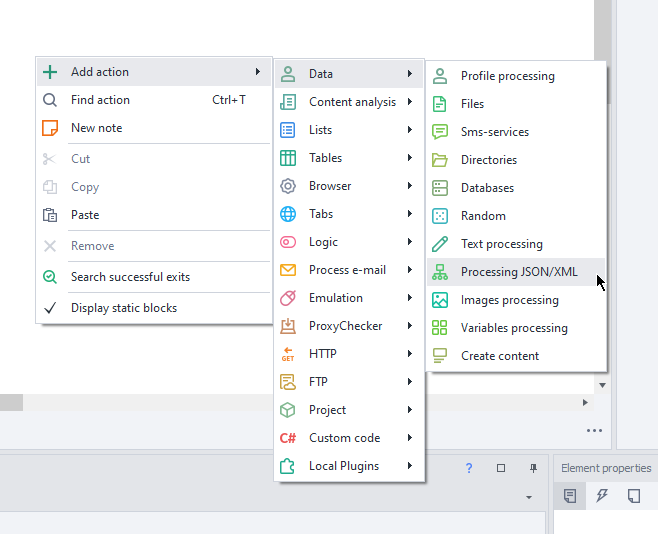

Or if you just need to work with json then you can use cubes
If be honest, i don't know how this cube works, he is return nothing, so what he actually do?? And I write C# code and don't want using additional "Bad behavior" action

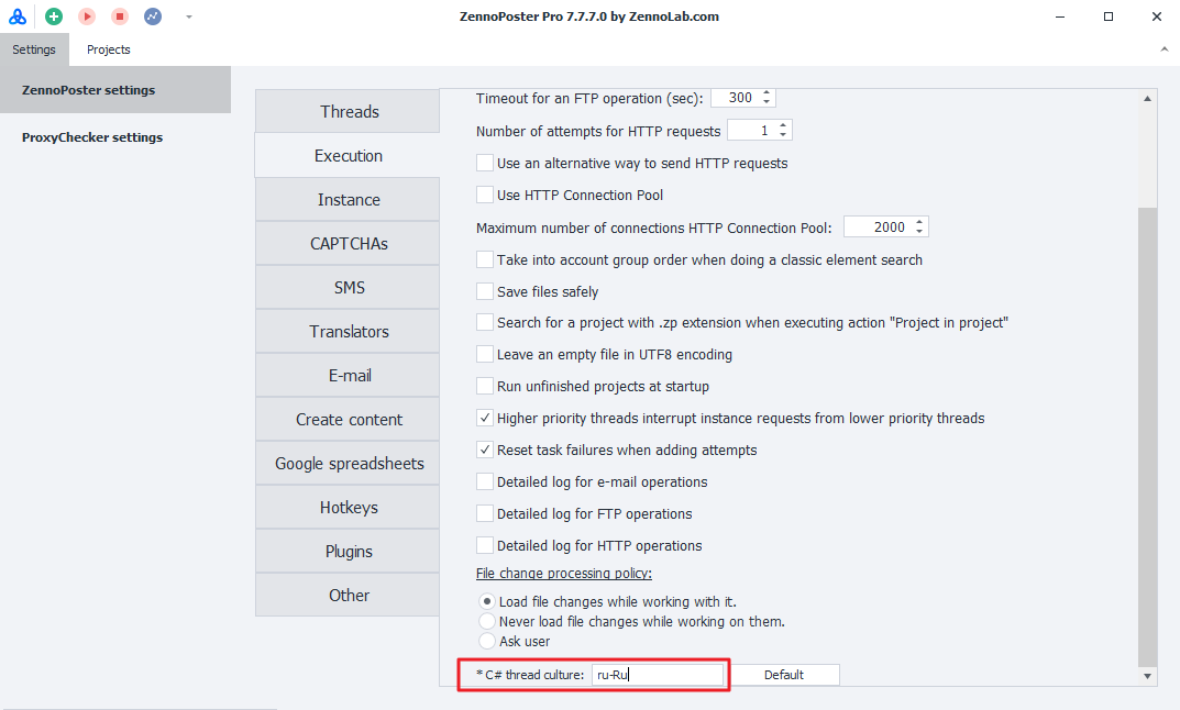

Check C# thread culture value in ZennoBox.
It must be the same as in your ZennoPoster
P.S. don't know why you dislike JSON cube, it's also based on newtojson dll which you use.
it just parses json code and output data to automatic json variables
