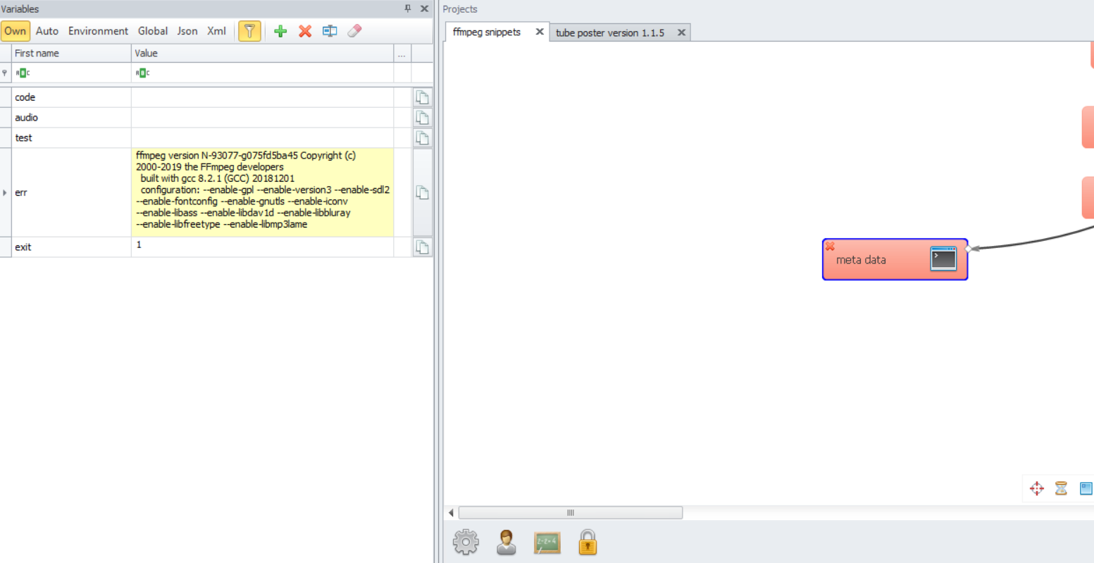

lately, i notice that run program give us a lot time false negative, I write console code:
-i input.mp4
and get all data, but in description wrote:
At least one output file must be specified

thanks, but now is a real error, video not created - and not like error
Error initializing complex filters.
Invalid argument

ok, i with simple metadata can check again all info about video, and check duration if not exist, video is not converted good , on test if file is corrupted, not show duration.

I have the same errors when use ffmpeg from "Run program" but mp4 everytime created successfully.
