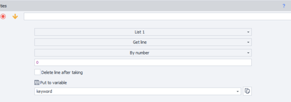

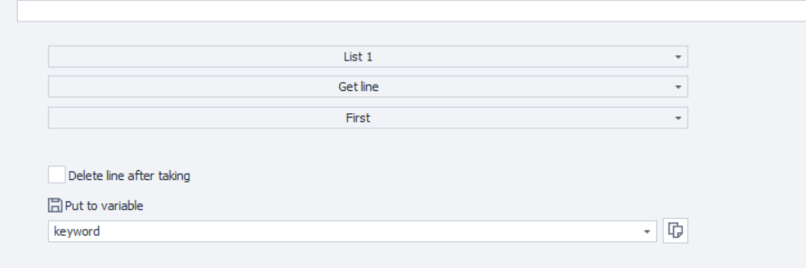

Hello,
I'am new user of zennoposter (i have the laste version 7).
I create a list with a variable keyword to take a fist line for the list1.....
64819
but whene i want to change to this ...i can't ...i mean they don't wont to be save it
64820
How can change it ?
Thank you.

Hello and welcome.
Because first like IS line with number 0.
So it just sets take the First line instead of line by number 0 because its just that same. :-)

yes is the same, but i want to take by line and put the number 0 and increase it by 1 ,so I can take line by line (without delete the line)

samy
02.10.2020
you mean i need put the variable here instead 0 ?
64838
samy
02.10.2020
I want to get line by line without delete the first one

@samy right you have to put variable where you put 0, and then you set the default value for variable 0, so then you will be able to increase this variable value by one and get +1 so next time you will get 1 line + then 2 line and so on.
There you should be able to read something about counters https://zennolab.com/wiki/en:looping?s[]=counter
