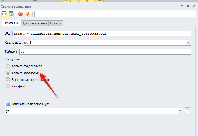

Retrieve only headers and make check if this pdf or not.

zenrast
20.03.2013
57
Nice:-)
Can i also check if the file is HTML? ...because maybe there are more those non html types...like .doc etc..
