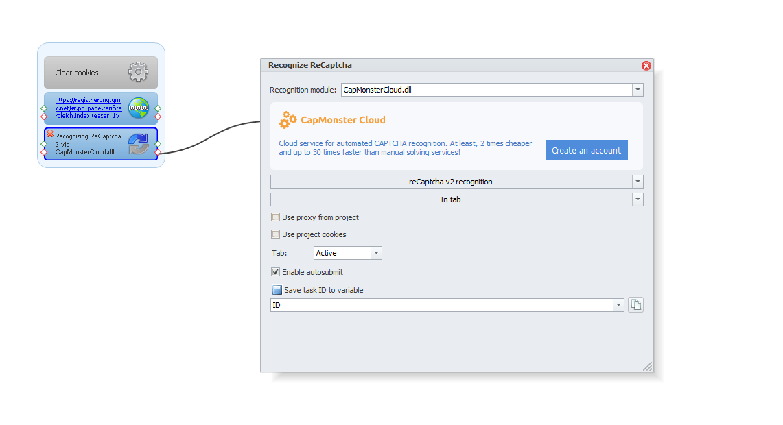

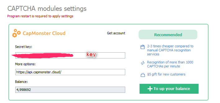

Thanks for your reply unfortunate its not working for me and i dont get any error i can work with.
51878
im using the 5$ of the new customer bonus for testing it. Key is right as you can see cause i already used value of it.
51879
using the right function but dont get any error on using it. (normaly on an error it shows the problem it has here it doesnt)
51881
settings of the recaptcha function. if my eyes doesnt lie to me its ecact the same as yours.
ofc i restartet projectmaker to safe the captcha settings. but for some reasons its not working.
thanks for your help
using the right function but dont get any error on using it. (normaly on an error it shows the problem it has here it doesnt)Посмотреть вложение 51881

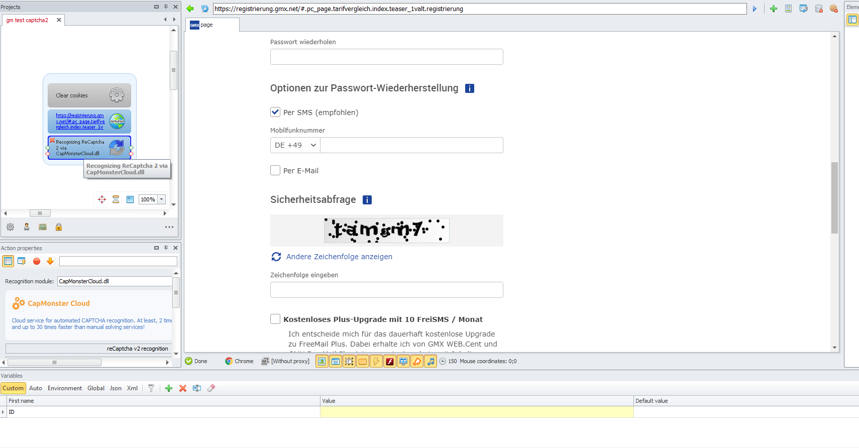

Well... this is not recaptcha, as far as I can see on your screenshot.... This is usual captcha which can be solve with "This is captcha" block.
I need to see what exact error you get solving it as This is captcha.
ReCaptcha is the captcha with I'm not robot and tasks to select certain pictures from images set. I don't know why, but I got recaptcha when registering in gmx.

Yes your right. I have the normal text captcha not recaptcha.
I tried gmx.de now with the normal "this is captcha" function and with CapMonster cloud and did 20 "runs" and it never solved the captcha even close to right. Is there a reason for the bad successrate and is cap monster 2 in that terms any better than cap monster cloud or do they have similar success rates ?
Didn't test it on any site so far maybe it's just gmx for some reason
22 233
5 846
Is tthe captcha nott solved at all with some error like Emptty answer or No answer,
or they solved with wrong characters in answer?
Please check log of recognized captchas in CapMonster Cloud.
