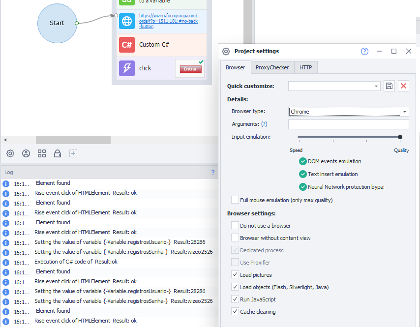

Try to change Input emulation (see screenshot).
When I set this setting to minimum "click" didn't work. But when I changed emulation level "click" worked.
69349
P.S. I am talking about "Entrar" button

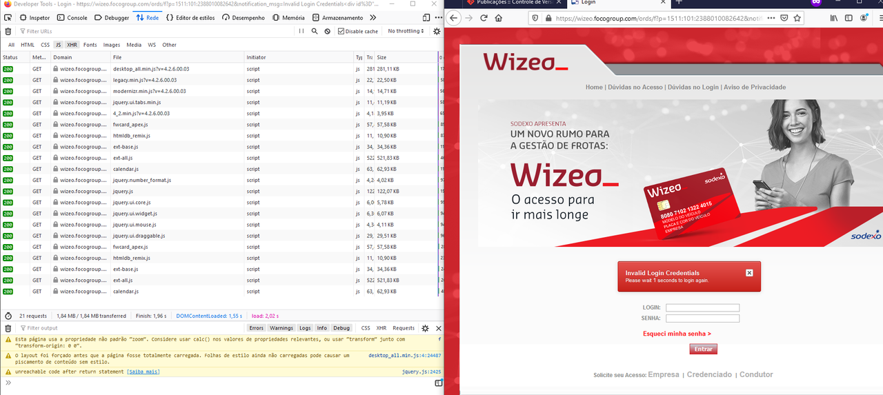

The click works, but it doesnt execute any type of interation with browser.
After click it must show "invalid login / password" and execute at least one get, like that image:
Tried that settings and still the same, no actions execute on traffic tab and "click" don't execute anything.

I've tested it on ZP 7.3.0.0
I've attached test project, try to run it.
  • 14,8 КБ Просмотры: 169

The action "click" work but it does nothing.
If you look the trafic tab, the action click don't do anything.
If you try to do a lot of manualy "click" in the same button inside the browser, the same action don't do anything.
If you do the same action in any navigator it will generate get/post trafic in network tab.
Attached, a sample mp4 file without audio, only navigation in browser / pm browser.

That's very strange, because it is working for me. Template from my previous message, ZP 7.2.1.1, Chrome engine
See attached gif:
69537
