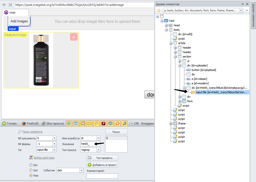

From the image before
https://post.craigslist.org/k/Vv0D4wJl6BG75QpUOw287Q/a69iS?s=editimage

Here you go, try this
Just change the file to an existing image

It could be. Try reinstalling something. Before doing that, doublecheck that you are using existing path to an image file.
I have just checked again, my version works seamlessly.
I did the test both on Firefox52 and Firefox45 engines.

Frederic,
Try this. Just run it from the very beginning. Asyou can see there are 2 versions, using "modern uploader" and a "classic" one.
Both work for me.
