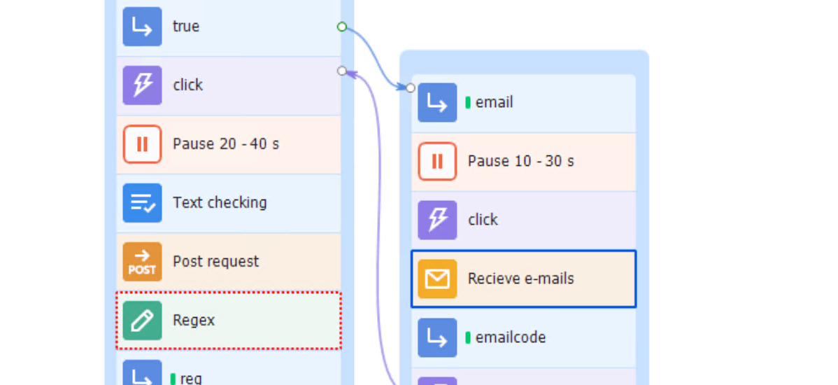

Here are screen shots of what I'm doing.

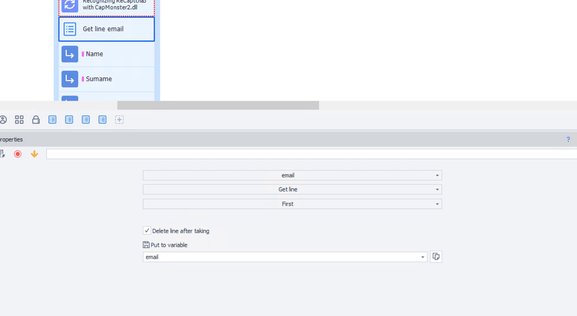

  1. get first line from list(there are emails), I turned this into a variable to be used in the module.
  2. Process emails for codes and grabbing them
  3. each code is unique to each email that signs up, issue is I don't know how to insert the variable from #1 into regex so that when the codes are pulled it's for the instance that is signing up.
  4. current regex to pull codes (?<=>).*(?=<) pulls code from last email synced - I want to pull code from unique email address per instance
  5. Works great when 1 or 2 instances are running so this is my last bug.:be:

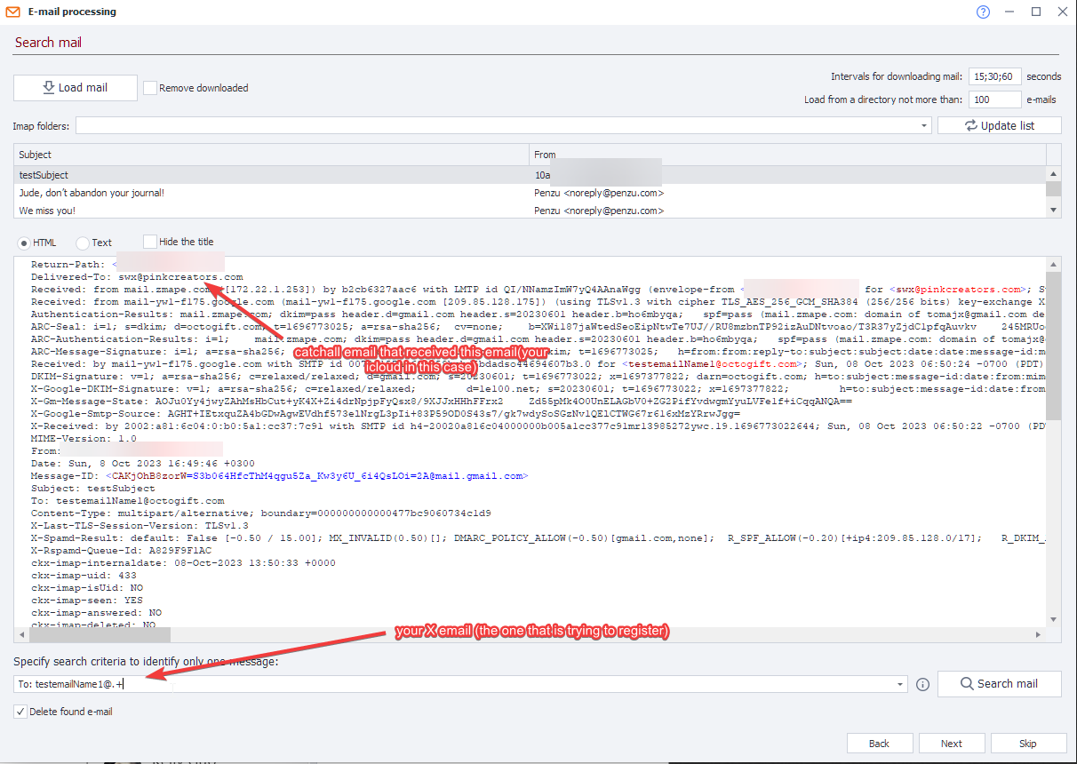

Goot it, if you aren't already, you should setup email by following this handy tool at the top by going to tools>Email processing and connecting to your catchall email
112684
Then following the setup in the 'search criteria' field search for your X email, it is shown in the email because it is forwarded to your catchall, so we can search with regex for it.
112686
And voila, you get the correct email
Hope it makes sense!
P.s I suggest checking the 'remove downloaded' so it does not mess up in the future, when the email does not come.

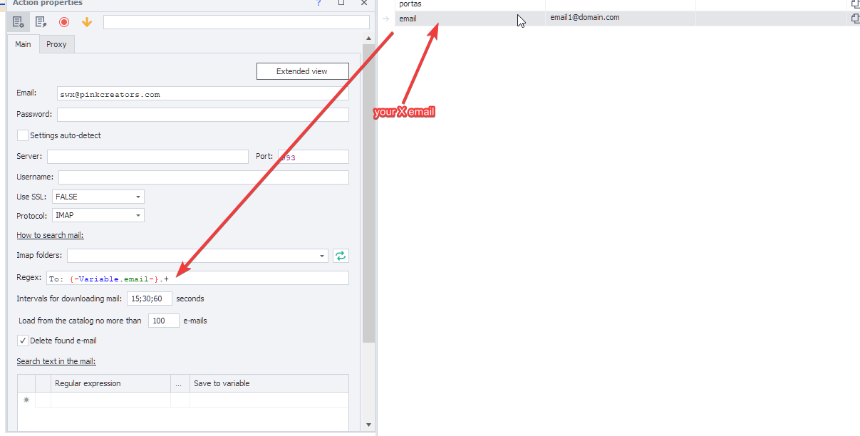

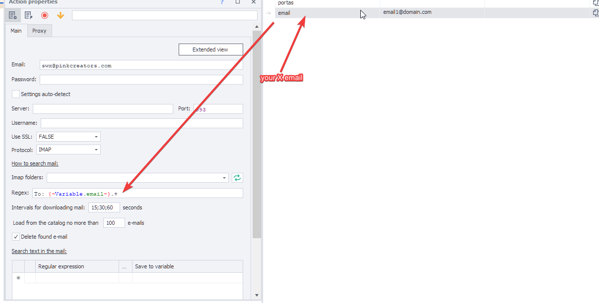

That's the whole idea, in the generated cube you of course have to place your X email instead, so each time it's looking for the correct one
112687
P.s , in your case it might not be exactly like " To: [email protected]" , each server could be treating it differently, you must check how it looks while following the email setup process, or enter your [email protected].+ , that should do it as well
Protip - you can use zenno variables pretty much anywhere in the cubes, don't be afraid to try
Реакции: syrl
Exactly what I needed! Works perfect now thank you!!!!!!!!
