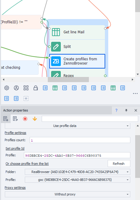

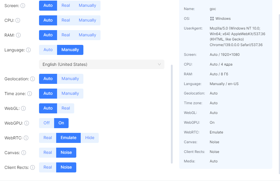

I set it to create a new profile based on the settings of a 'goc' profile. Does this mean it just clones the 'goc' profile, or does it create a completely new profile using the 'goc' settings? Because when I create a new one this way, the fingerprint check keeps failing—the fingerprint doesn’t look like a real one.
This means a new profile will be created basing on settings from goc profile. What are fingerprint checks that failed?

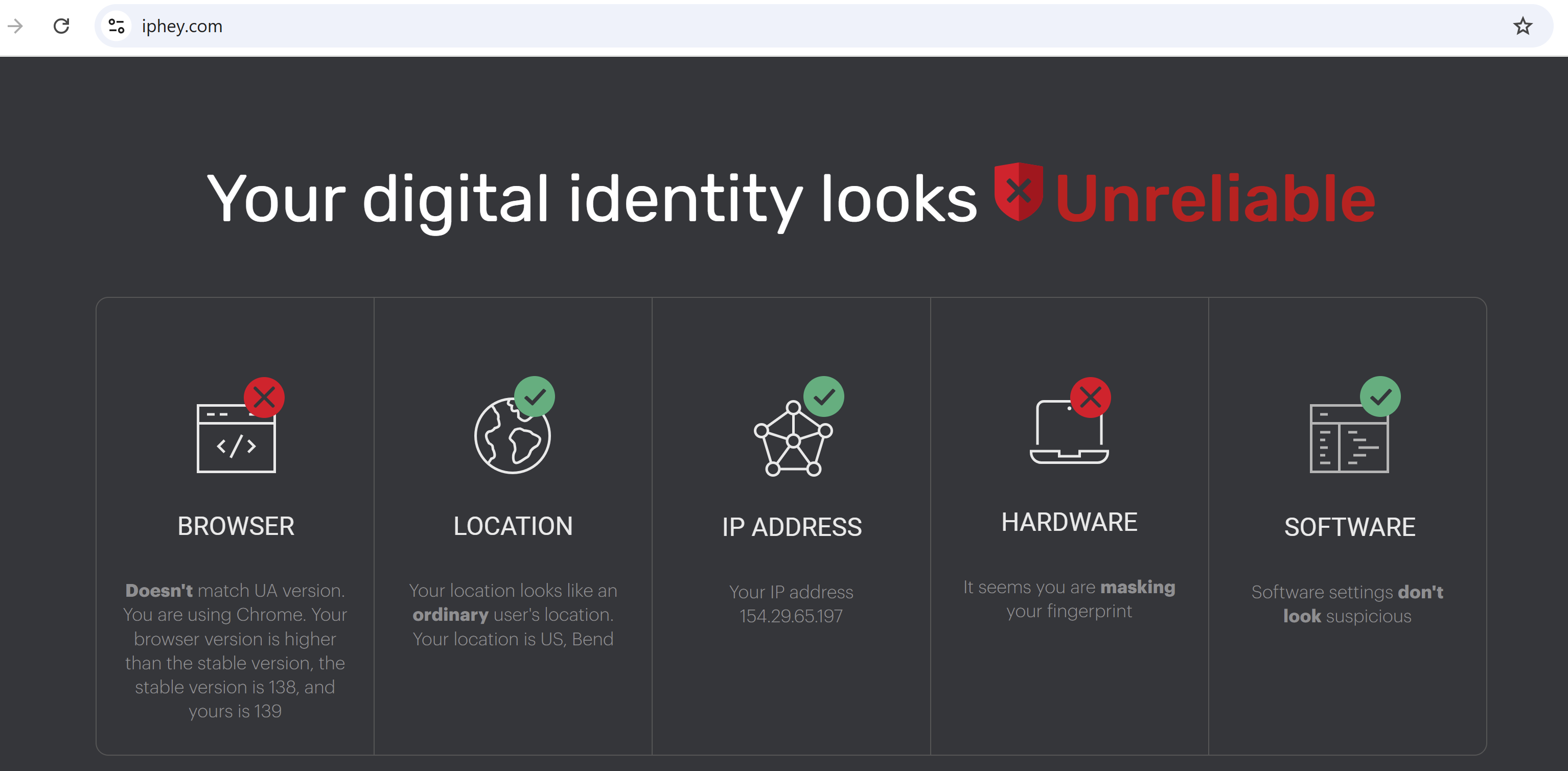

I checked via Iphey.com and pixelscan.net

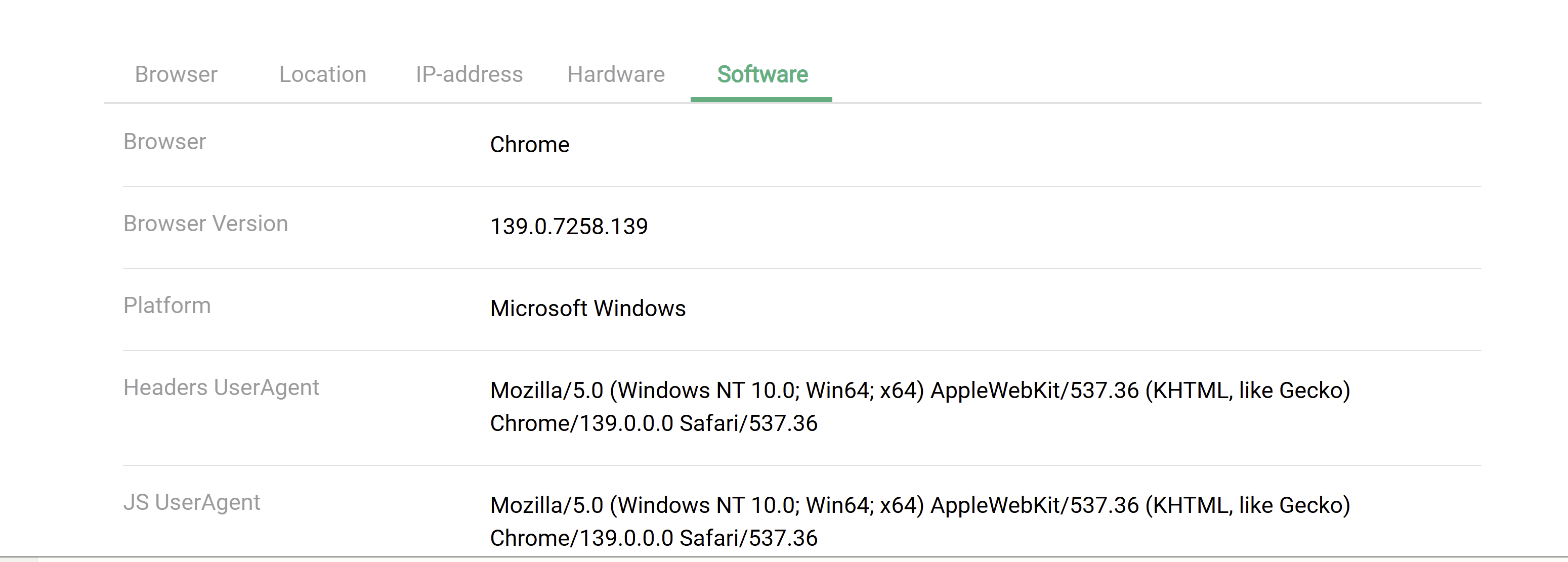

This is the profile I created based on the 'goc' profile through ZennoPoster

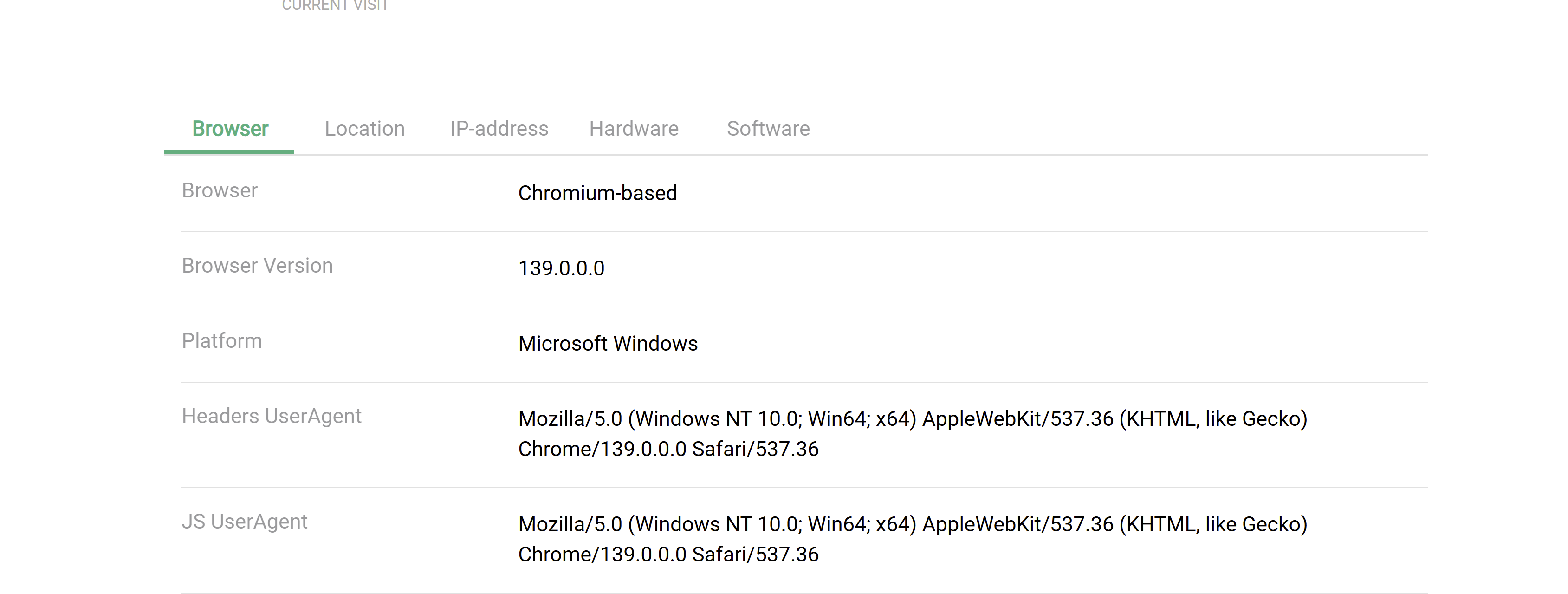

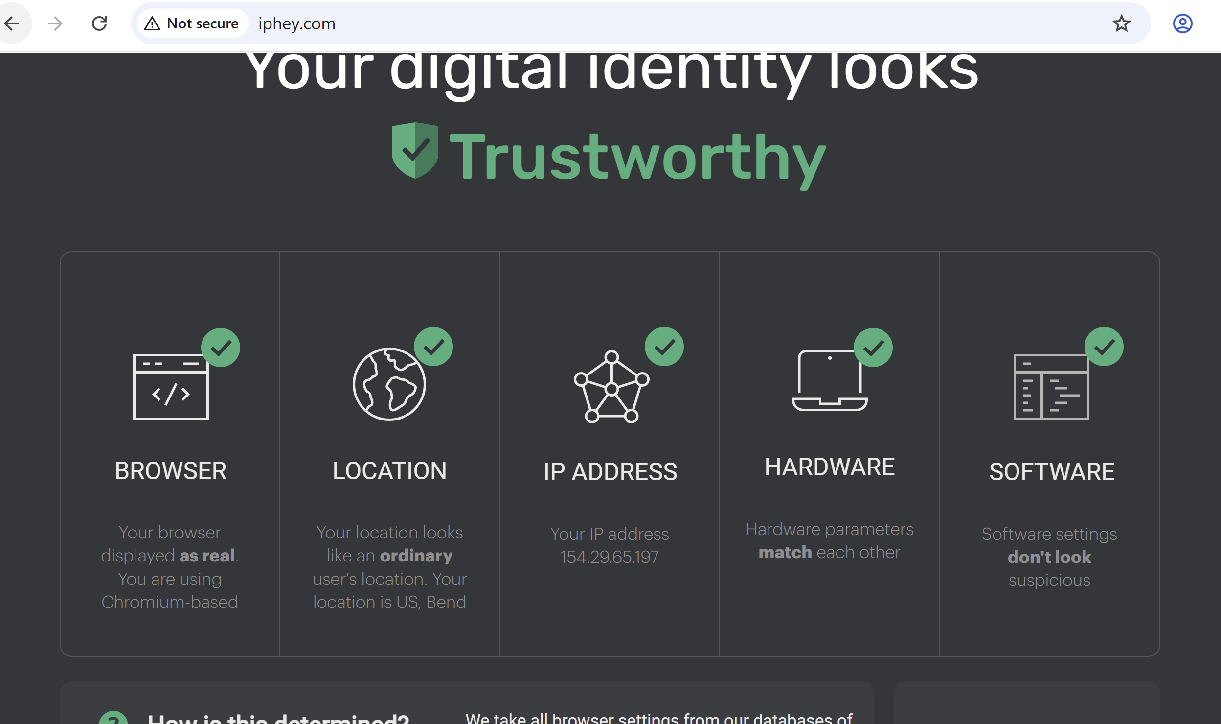

This is the profile I created manually with the same settings as the 'goc' profile.
135920

I have checked between real and not real. The difference is that the real one is Chromium-based, while the not real one shows as Chrome. How can I make it always show as Chromium-based?
