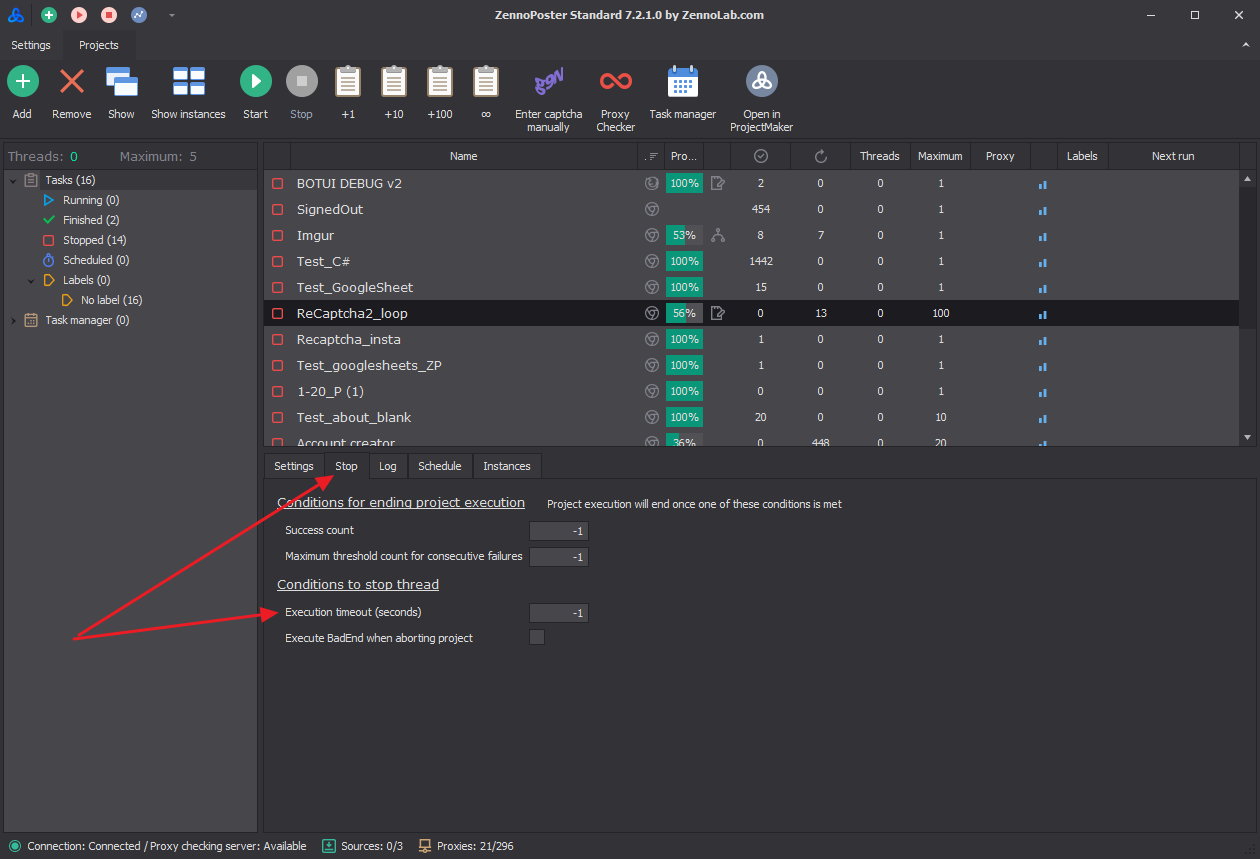

The program will close inactive instance by itself within time.
You can also set execution timeout in template task settings. Within this timeout instance will be forced to closed.
