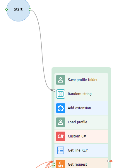

I have Zenno poster PRO(Just upgraded) and would like to use a lot of threads to run a single project.
The project starts like this:
119584
I do not know why but when I add this project to Zennoposter and try to run 10 threads, only 1 thread runs, all the others keeps restarting but never run.
From what I understand, it looks like Zenno creates 1 folder and can only run 1 instance of a thread in that profile folder.
I need to be able to run 10 threads using the exact same profile because the same chrome extension settings will be loaded anyway on each run.
I am not understanding why Zenno cannot run the same profile 10 times.
I am saving the profile only once and then try to run the 10 threads, in that profile I have an extension API key and tick box checked.

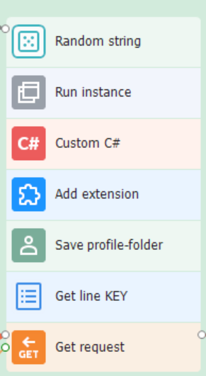

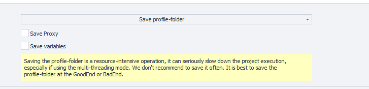

Here is how I save the profiles:
119586

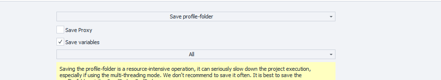

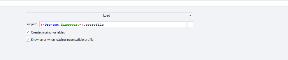

And this is how I load the profile:
119587
Any idea what I am doing wrong please?
Thanks.
22 810
6 037
I don't see you are using profile-folder.
I see you are just loading zpprofile file.
What does "threads leeps restarting" mean? do you get any errors in log trying to run threads?

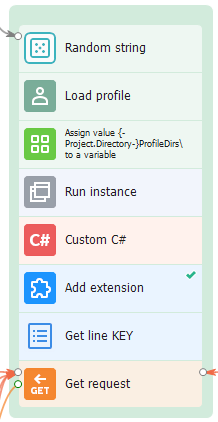

I have modified the project to work with a profile folder as shown below.
119649
But I still cannot run more than 1 instance of this program, I get this error in the Zenno poster:
Running the WebBrowserSettings Browser cannot be run in specified folder ( G:/user/account/xxxxxxxxx ), as it is already in use by another browser instance!
Any idea why please?
Thanks

That's right, 1 profile-folder can be run with 1 instance only at the same time.
You should create several profile-folders, to run multiple instances.

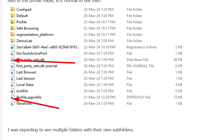

Also in the profile folder, is it normal to see this?
119679
I was expecting to see multiple folders with their own subfolders.

* One profile folder can work in one thread. If you want more threads just duplicate profile folder and run each thread with its own profile folder.
You are mixing profile files .zpprofile with profile folders its not really clear what are you doing as those are two different ways to manage profiles. profile files do not work with extensions, so just cut them out in general.
* You are using some cloud storage that upload files as per your image. When files get uploaded they are locked by cloud provider onedrive/gogole drive etc. Zenno cant access those files and folders while they are in sync mode, move your profile files out on your PC and try again...
Still, one profile folder can work in one thread only. You cant run multiple threads on one and that same profile folder.

What do you mean? Update templates and have to delete profiles.
You are making automation man, so make one for copying, updating, deleting your profiles from another template if that's what you need.

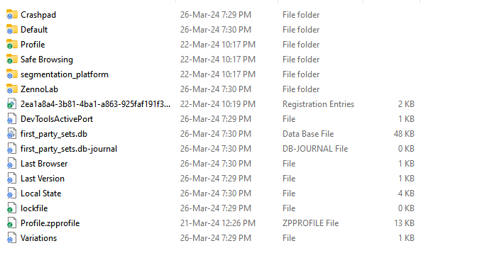

119776
Those blue round things mean files get synced with Onedrive, perhaps. Those green checkboxes mean those files are already synced.

Ok I see what you mean. I have actually synched them locally now, I must have taken the picture after this change sorry.
I am using Google drive with the stream cloud, but when running the zenno project, the files are local and drive paused not to cause unecessary load.
