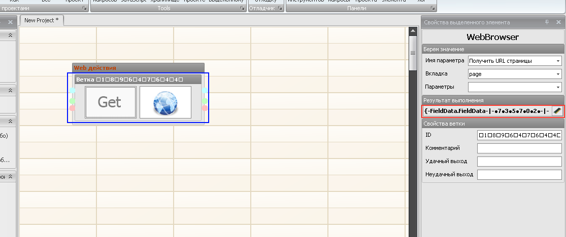

Taking the result of the branch in the usual way does not fit?
    45,4 KB · Просмотры: 745
For many situations the usual way works very well.
But lets say you have a complex macro or javascript that you'd like to use in many places in the template. Is there a way to retrieve the result of the last executed step so that its not necessary to repeat the same complex macro many times?
For example several branches might lead to a common step, but the processing is dependent on the output of the preceding step, the incoming link.
