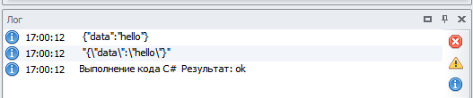

object ob = new{ data = "hello"};
string json = Global.ZennoLab.Json.JsonConvert.SerializeObject(ob);
project.SendInfoToLog(json);
json = Global.ZennoLab.Json.JsonConvert.SerializeObject(json);
