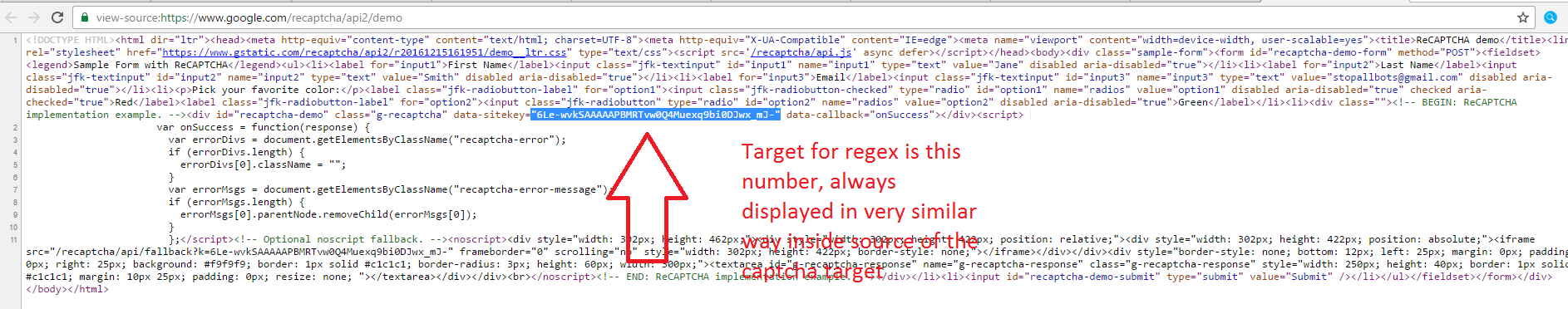

1. Make a new regex to get google key from targeted site.
OR
Hard code google key if you wanna use just for one specific site
2. Put in both 2captcha key and targeted site URL inside first GET box (full url https://www.site.com)

First Dom in Morgan's template capture Google site key, but you can skip this step, find site key using page source and hardcode this key directly in the url of the first GET request without using any variables.

That is correct.
This is stated in my post above where I also show what google key looks like :-)
