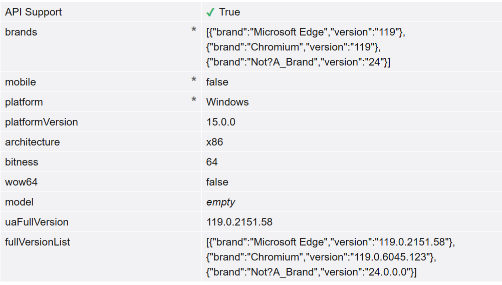

How to modify the data in navigator.userAgentData is really important to us. I have seen many users submit this request but have never received a reply.
JavaScript:
navigator.userAgentData.getHighEntropyValues(
    ["architecture", "model", "platform", "platformVersion", "uaFullVersion"])
       .then(ua => { console.log(ua) });
114060
Executing this method will leak a lot of device information. I want to change it, just like modifying userAgent.

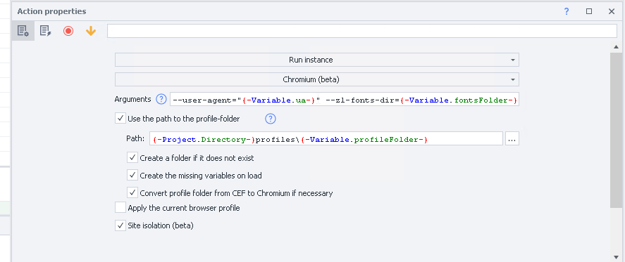

when starting the instance you can set the user agent in chrome, that should also automatically get used in navigator-

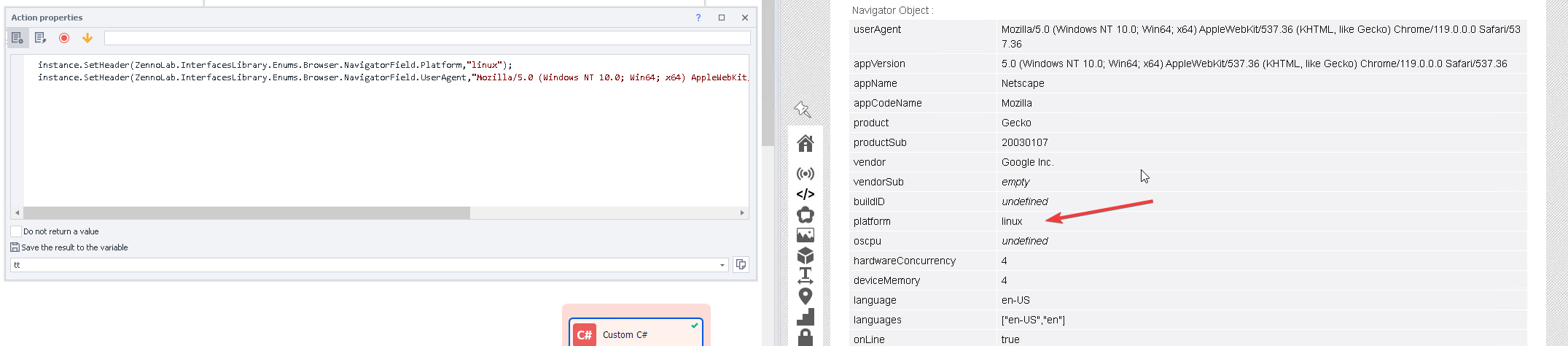

Some example how to set the navigator fields
instance.ShowNavigatorField(ZennoLab.InterfacesLibrary.Enums.Browser.NavigatorField.Vendor);
instance.SetHeader(ZennoLab.InterfacesLibrary.Enums.Browser.NavigatorField.Vendor, null);
instance.ShowNavigatorField(ZennoLab.InterfacesLibrary.Enums.Browser.NavigatorField.VendorSub);
instance.SetHeader(ZennoLab.InterfacesLibrary.Enums.Browser.NavigatorField.VendorSub, null);

NavigatorUAData(navigator.userAgentData) different form user-agent
Detail page:

Give it a try, at least I use it like this

Hi. myndeswx
I have tried the method you gave and found it to be useless. (I have looked through the zp development documentation)
This is a completely different approach.
You can try the following code and you will find that your modifications will not take effect.
