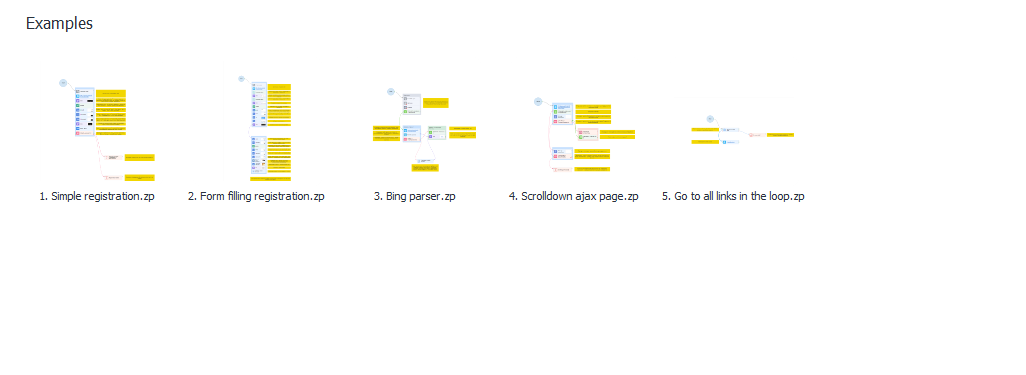

Hi, are you asking about the Code Creator? I don't think this is anywhere up to date.
About if action, did you look for example projects on zenno homepage?
104758
Any action like click or enter text in field have red dot as exit. If you connect next action to this red dot, then whenever error happens ( element is not found on page) it will go out by this red connection. Therefore you can connevct your next steps there.
Does that answer your question?
