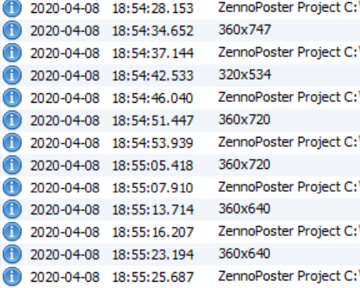

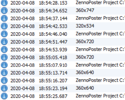

please see the dimensions displayed during the executions I tried:
53394
I believe that 50505 is another bug I think I read in the russian forum
