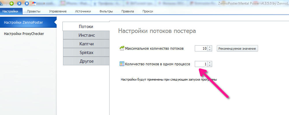

That is how it works.
You can set 1 instance per base if you need that much to see whats happening in your instances.

he ment base, under settings, but that makes it eat shit load of ram... so not really useful :D

the other problem is if using socks5 proxies, all threads will use the same proxy. the only solution is to set 1 instance per base but then your using a lot more memory.

What does it mean "base"? where can I change it? what does it actually do?

I use 5 threads per base. I think it's optimal for speed and stability.
