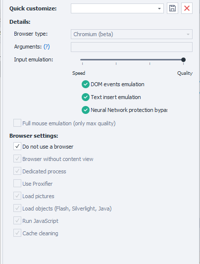

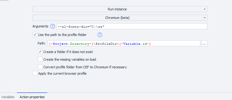

could you attach the screenshot of run instance action properties ?
do you use it in non-browser project?
103286
yes i use non-browser project.
103287
it's a bit weird. because if I save the project under a different name and run everything works fine. profile loads in 2 seconds. However, after 10 minutes, the profiles start to load slowly. and sometimes it takes up to a minute. runs on 8 threads
Please make diagnostic right after such a long start (see the instructions here) and send me the report.
