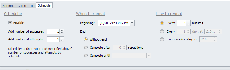

I would like to have a template execute every 3 minutes let's say... forever (or as long as Zennoposter will remain stable). How can I achieve this? I've tried adding a template, selecting Enable Schedule, on what I thought was an endless loop?
The template eventually goes to Remaining Attempts = 0 and doesn't execute at all?
Set number of attempts -1 and wait )
I had problems with scheduler earlier too.
Try to set the time of beginning to the next hor or so)
Future time
I can set attempts to -1 in Settings, but not Schedule. Is that what you're saying? Schedule is not allowing me to set it below 0.
Ah -- think I may have got it. Under Settings I have -1 for success/attempts. Under Schedule I have 0 set for both so it remains at -1.
The logic is simple:
Every 3 minutes the scheduler adds number of success and attempts from your screen to the main settings tab :)
Yes, simple once you realize -1 is indefinite setting :)
