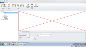

I added a template into ZP 5. I've set the execution count to 1, after that to 5, and also set 5 threads. Here is a screenshot: 4pIZhua.png
If you can please solve this bugs as soon as possible.
