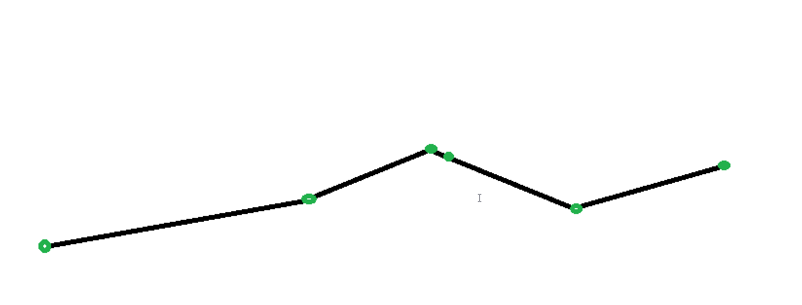

It would look something like this if we draw a route on the map -

Turns out there is some issue, sometimes more coordinates are added, and sometimes not enough: al:
Much easier to see it visually
The the the Input of The Is the list of the the this coordinates-
This is the coordinates for the this Map-

87294
And the this is what the script generates-
87295
For some large Have for We the GAPS, and sometimes Do the Do 'drift' off course the the
This is the Desired result-
87296
If you or someone else would like to work to finish it please let me know, willing to pay of course!
