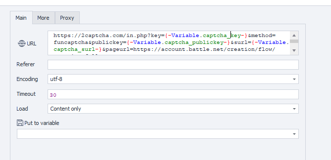

Need Help With Sending Funcaptcha to 2captcha
nomie7
06.06.2021
15
I'm not sure what am I doing wrong here. Can someone please help. I did setup my api key in the settings and it is bringing out the balance.

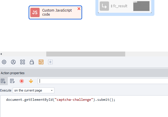

thank @nicanil that worked. Now the next step I don't know it's still showing me the captcha even after following all the step. If someone can help i would really appreciate that
22 829
6 040
You should run JS script (Own cide>JS action) to submit token:
JavaScript:
document.getElementById("captcha-challenge").submit();

Can you please explain how do i do that.
tried this and it didnt work

Thanks for all the help i found a solution.
cutesandcat
23.05.2020
zmike
24.10.2019
156
Would you share how you solved the problem? @nomie7
nomie7
06.06.2021
15
@cutesandcat @zmik
submit the form with the JS method mentioned above. You might have to find the correct id of the form.
