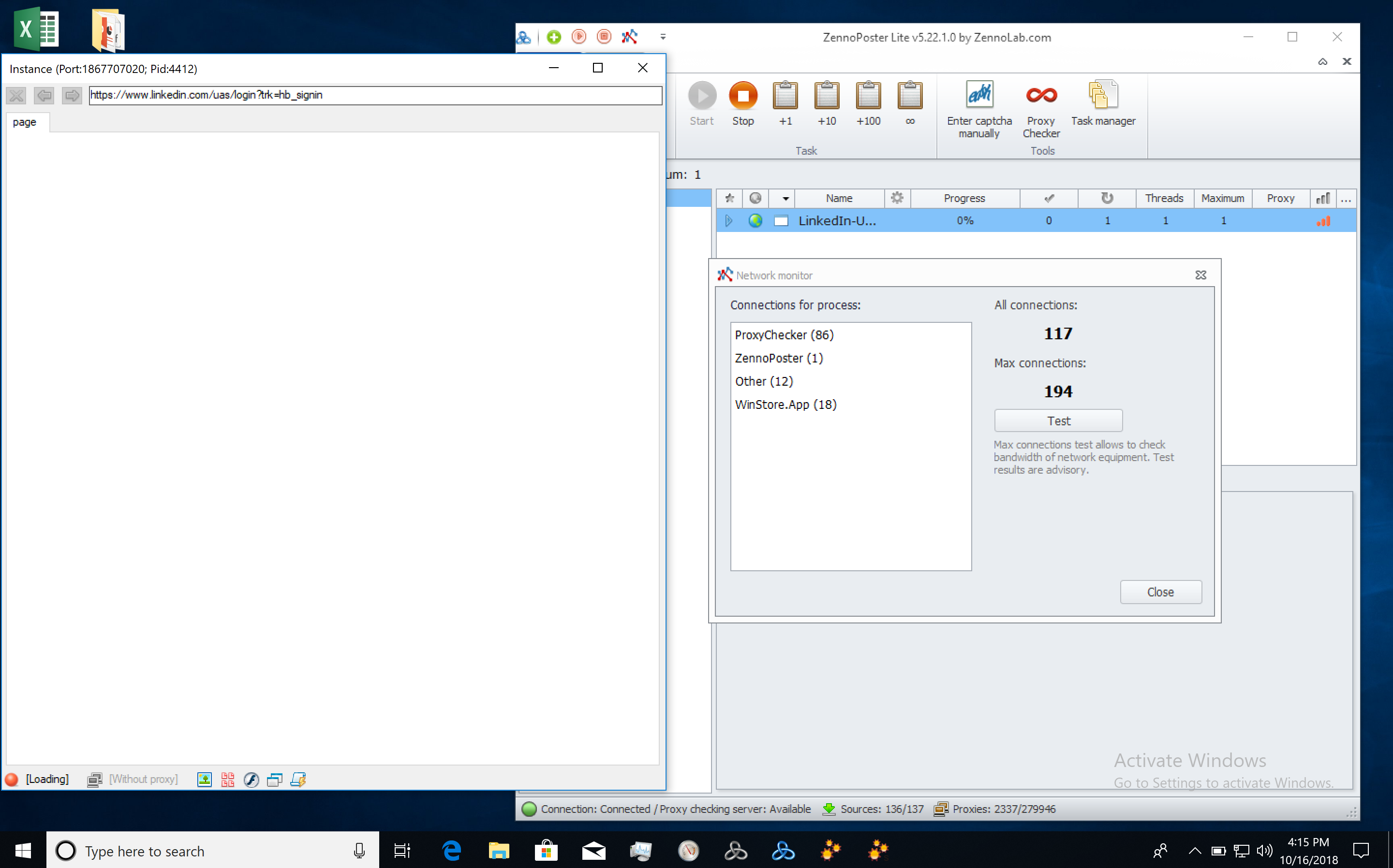

Hey all -
I am having issues getting my projects to run because it always says "LOADING" and will timeout. I assume this is a network issue on ZennoPoster's side?
I have successfully ran this project over 20+ times but I am noticing that there seam to be peak times to do so, not sure the determining factor(s).
Can anyone explain what the attached screenshot is showing and what are 'good' benchmarks (indicators) to run a smooth and fast project?
Also, any insight on using the 'Network Monitor' tool would be helpful too (testing, etc.)?

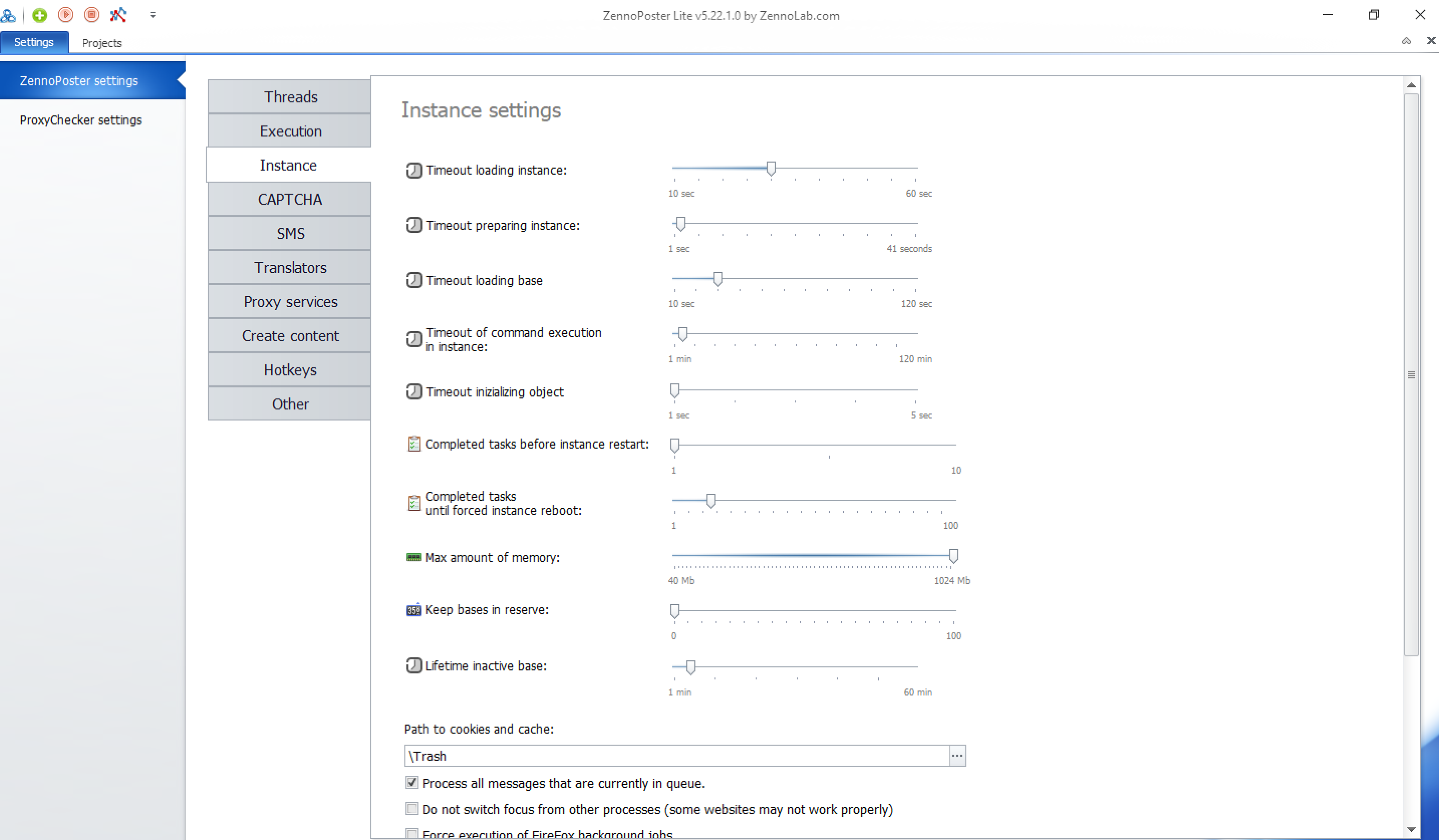

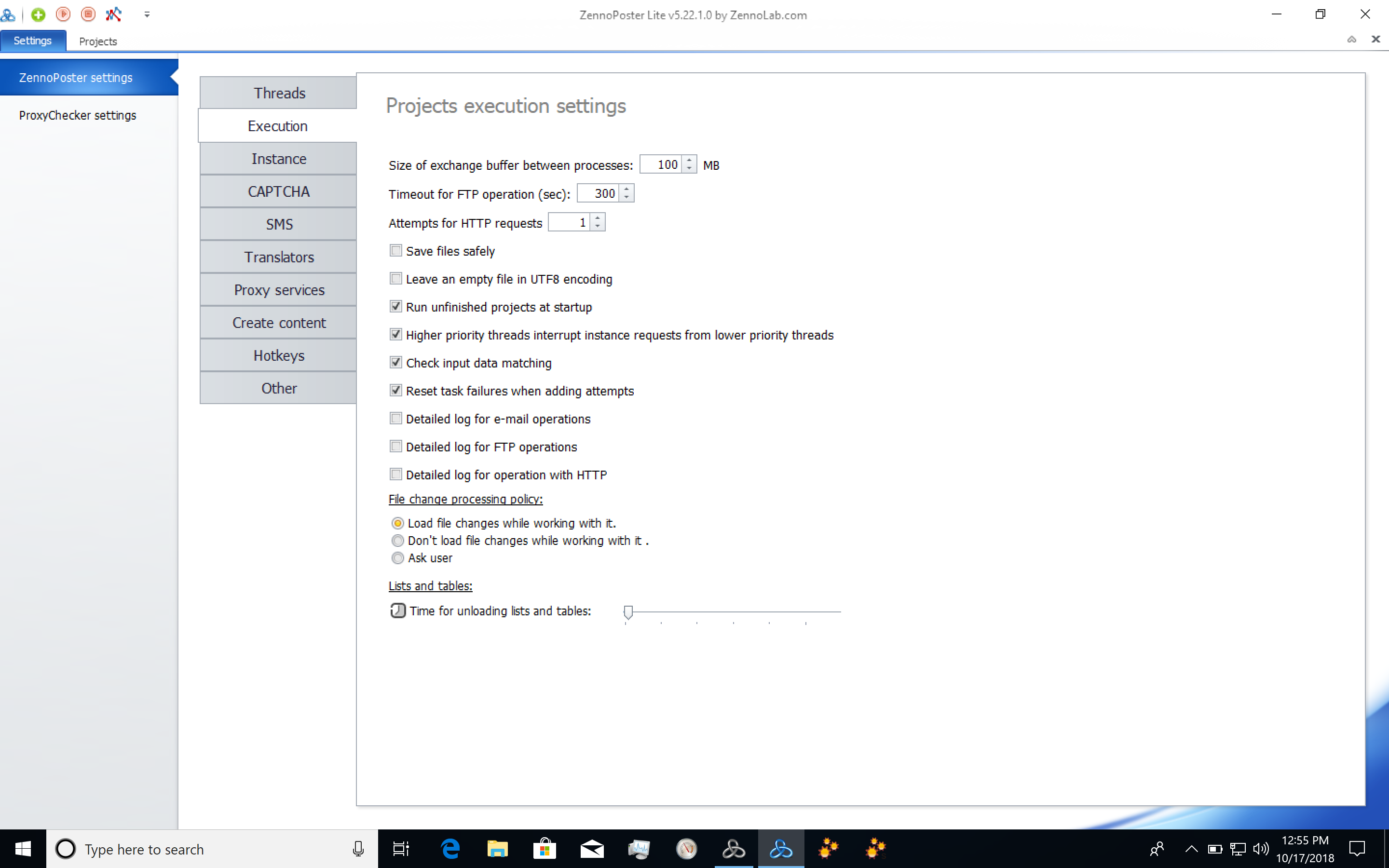

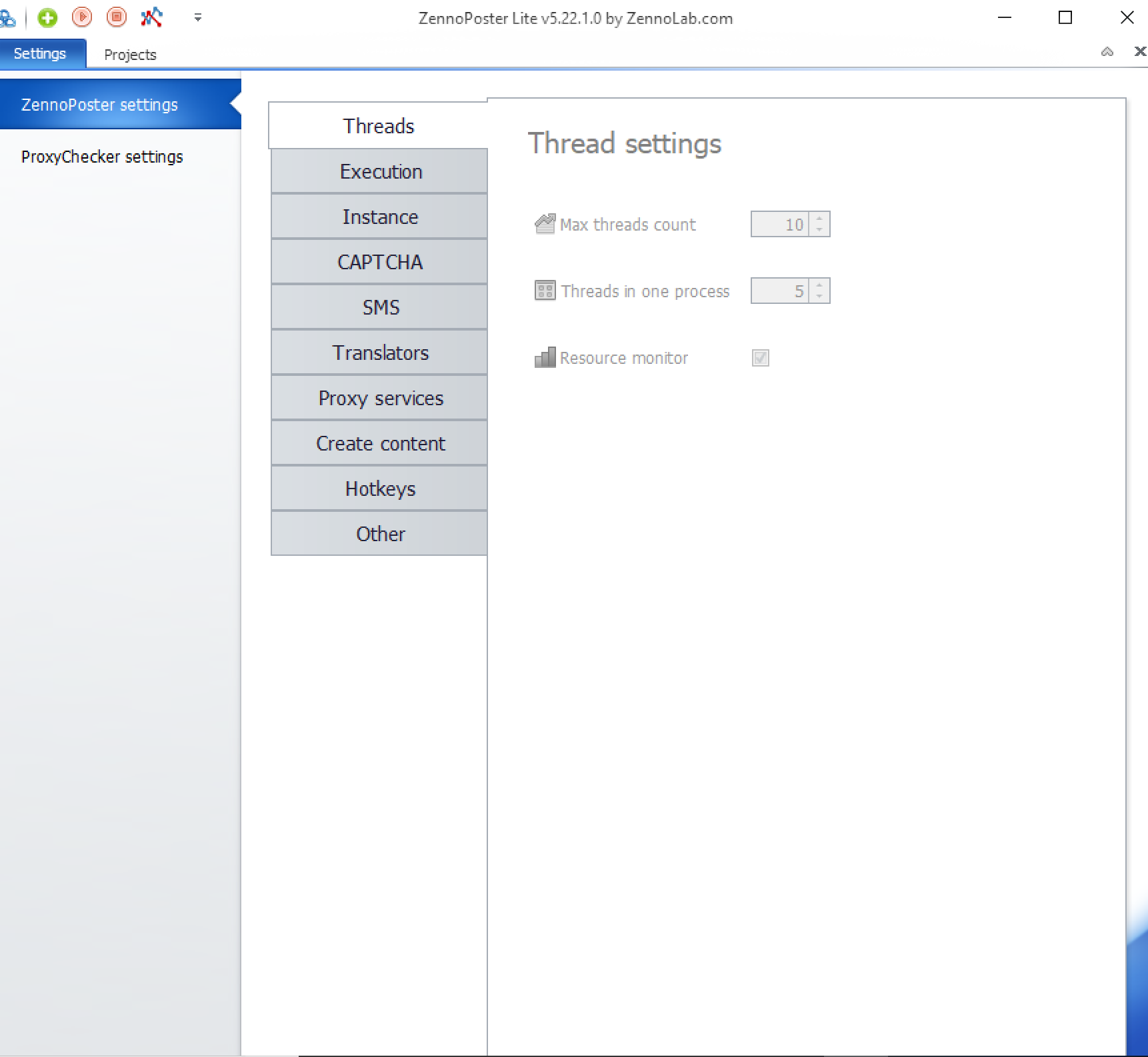

Please attach screenshots of program settings> tabs Threads and Instances
Grapidly
16.10.2018

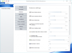

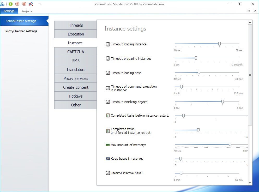

22 796
6 025
With minimal instance and base timeouts you won't run any thread.
Set them as shown on attached screenshot.
