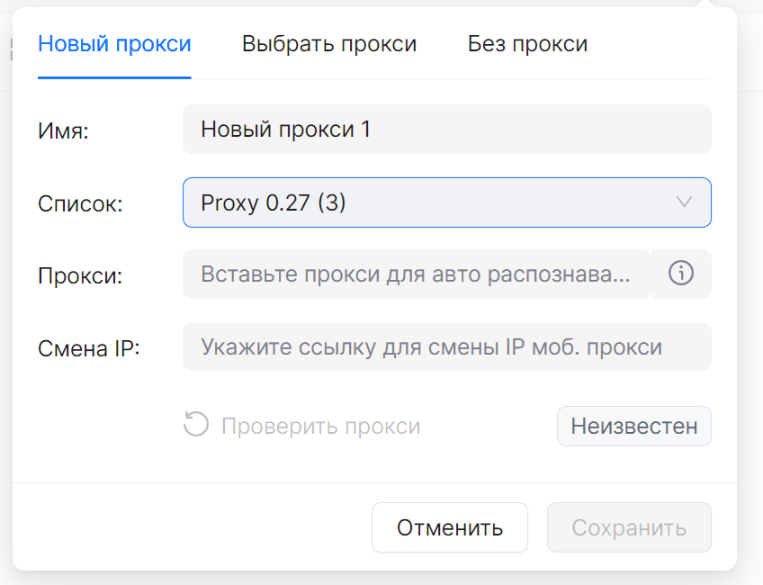

Добавили функцию обновления IP для мобильных прокси - если у вас есть ссылка на смену IP, то вы можете менять IP прокси на по запросу из интерфейса

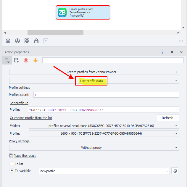

Hello everyone! Today, I finally got access to ZennoBrowser and couldn't wait to try it out. While using it, I noticed an issue that I hope could be improved:
When creating new profiles using the Project Maker and selecting “Create profiles from ZennoBrowser,” the default language is set to automatic. However, the browser profiles I create always display in Russian. This causes a mismatch between the language and my proxy settings, which disrupts my workflow.

Hello,
Please clarify, do you use a reference profile when creating a profile, on the basis of which new profiles are created? What settings do you have set up in the master profile?

Hello,
Hello.
When creating the configuration file in ProjectMaker, ZennoBrowser did not refer to the configuration file but used the default settings. I also used the default for the main configuration file and did not modify any options. Looking at your picture, I think I can create the configuration file on the main configuration file with the language set to match my proxy, and then when creating the file in ProjectMaker using ZennoBrowser, I can create it based on the modified language main configuration file.
Thank you very much for your answer.
Hello.
You write about a configuration file. Please specify what you mean by it? I think that we have some differences in terminology that now prevent me from understanding the cause of the situation. You can also send screenshots if they help to understand the situation.
Реакции: zhangsan2020
Dear Mr. Sergodjan.
After seeing the picture you sent above, I have solved my problem. Your diligence is worthy of admiration. Thank you again.
