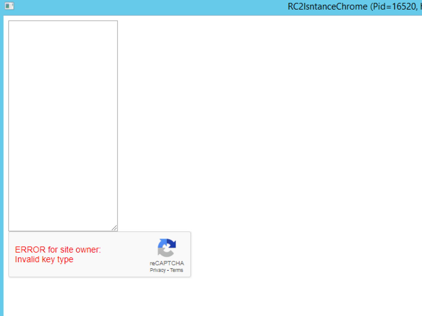

I'm using the default method which is Chrome and i tried that option show browser in recaptcha shows me this error

For some reasons, website is not open for me...
Are you sure are solving correct recaptcha type?
When you get this error "Invalid key type", this meanse there is recaptcha3 on a webpage, but you are solving it as recaptcha2 in CapMonster.
So you should check captcha type in your software when you send it to solving in CM.
