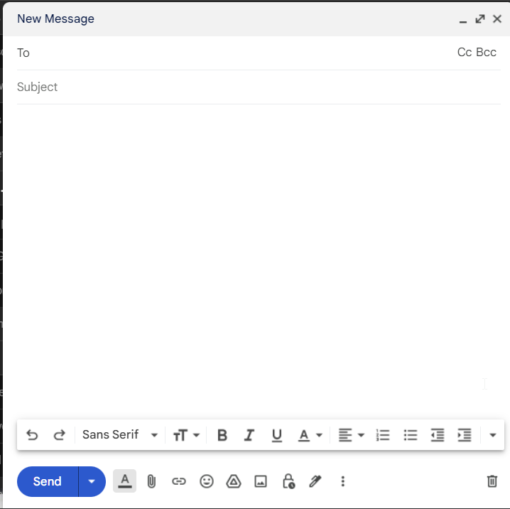

Hello, not sure if it's a bug or not, but with chromium I'm having this issue a lot - some elements are hidden off screen, like in this example at the bottom of gmail there should be a 'send' button like this -

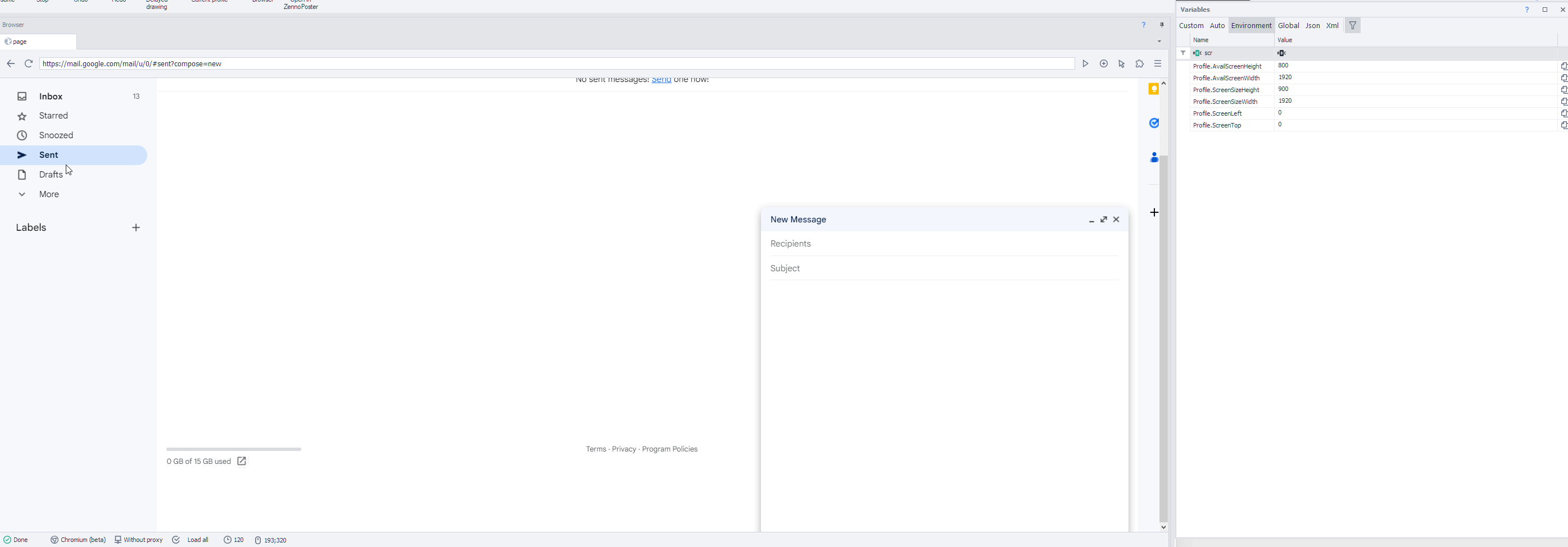

But in the PM and ZP it is out of vision-

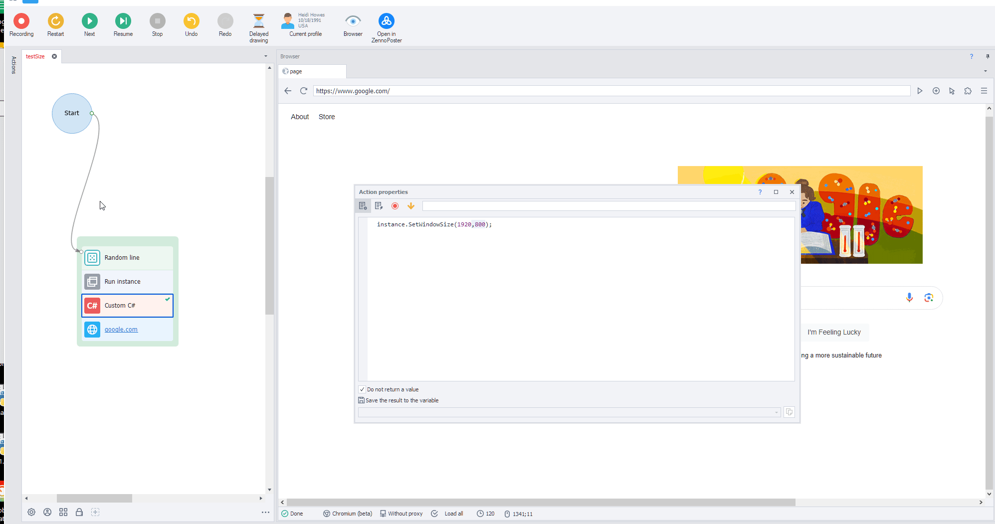

Project settings-

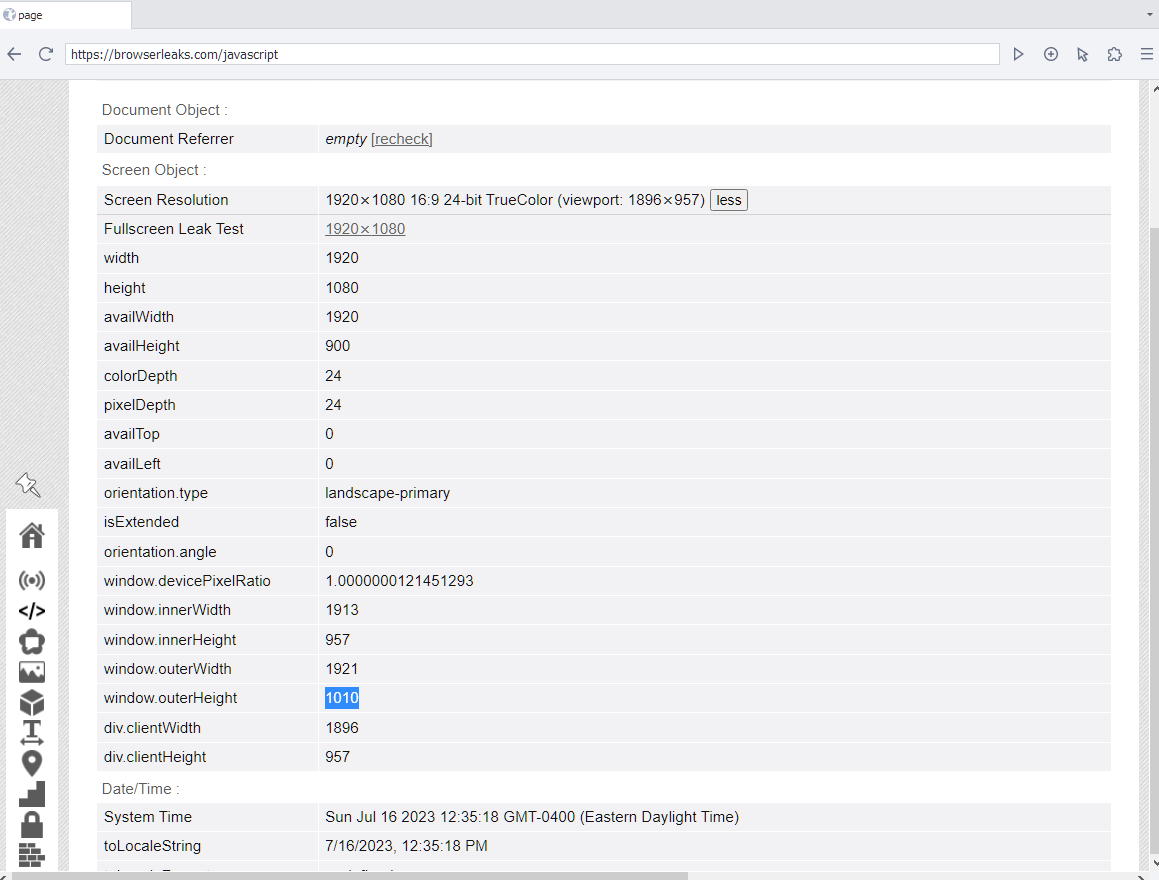

Checked in browserleaks, it gives strange outerHeight for some reason, not sure, maybe that's the issue?

Thank you, so it means the profiles window size must be not larger than your actual screen? Just trying to clarify, because for profile randomization I am using different screen sizes (some larger than my actual screen).
Thank you
Edit.

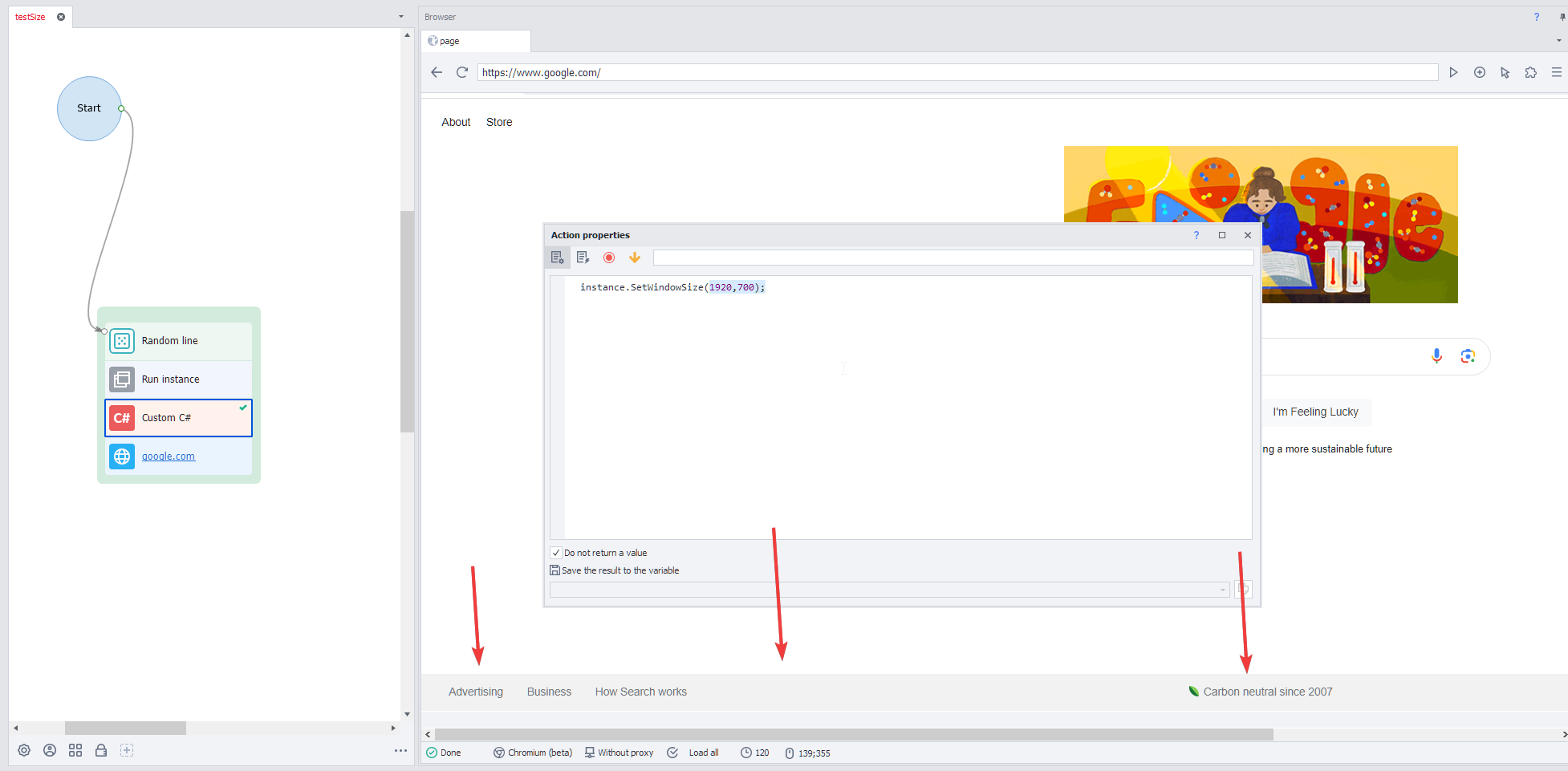

Tested your suggestion with a clean profile, I must to set the resolution to 1920x700 to start seeing the bottom of the page, something is definitely off..
109481
The machine that project is running on has resolution of 3840x1080
Attaching the test project as well, thank you
