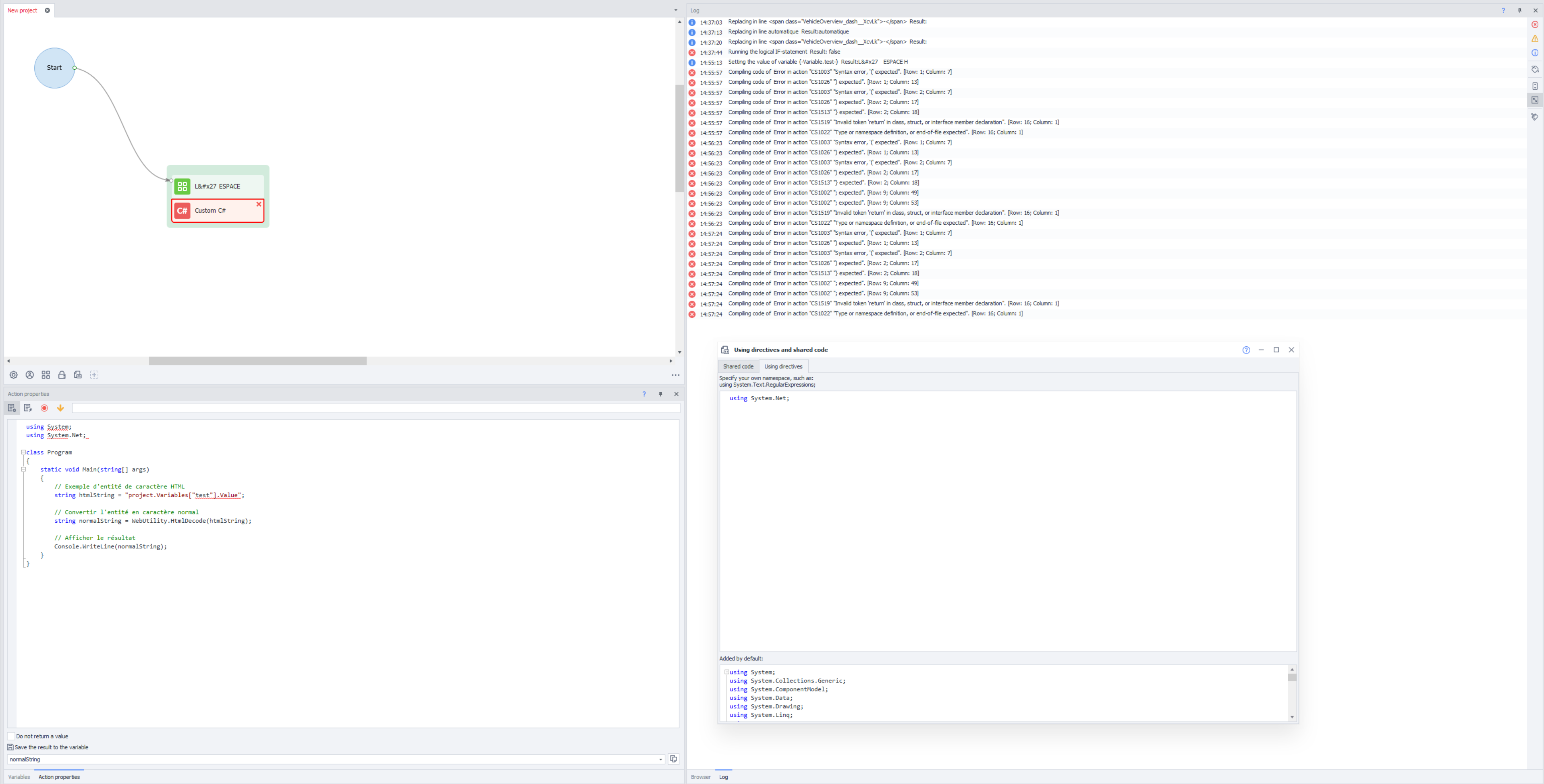

I had forgotten to add the return command so I added it however I still have the errors in my script.
using System;
using System.Net;
class Program
static void Main(string[] args)
// Exemple d'entité de caractère HTML
string htmlString = "project.Variables["test"].Value";
// Convertir l'entité en caractère normal
string normalString = WebUtility.HtmlDecode(htmlString);
// Afficher le résultat
Console.WriteLine(normalString);
return normalString;
Type Time Message
15:16:46 Compiling code of Error in action "CS1003" "Syntax error, '(' expected". [Row: 1; Column: 7]
15:16:46 Compiling code of Error in action "CS1026" ") expected". [Row: 1; Column: 13]
15:16:46 Compiling code of Error in action "CS1003" "Syntax error, '(' expected". [Row: 2; Column: 7]
15:16:46 Compiling code of Error in action "CS1026" ") expected". [Row: 2; Column: 17]
15:16:46 Compiling code of Error in action "CS1513" "} expected". [Row: 2; Column: 18]
15:16:46 Compiling code of Error in action "CS1002" "; expected". [Row: 9; Column: 49]
15:16:46 Compiling code of Error in action "CS1002" "; expected". [Row: 9; Column: 53]
15:16:46 Compiling code of Error in action "CS1519" "Invalid token 'return' in class, struct, or interface member declaration". [Row: 17; Column: 2]
15:16:46 Compiling code of Error in action "CS1519" "Invalid token ';' in class, struct, or interface member declaration". [Row: 17; Column: 21]

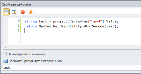

string text = project.Variables["test"].Value;
return System.Net.WebUtility.HtmlDecode(text);

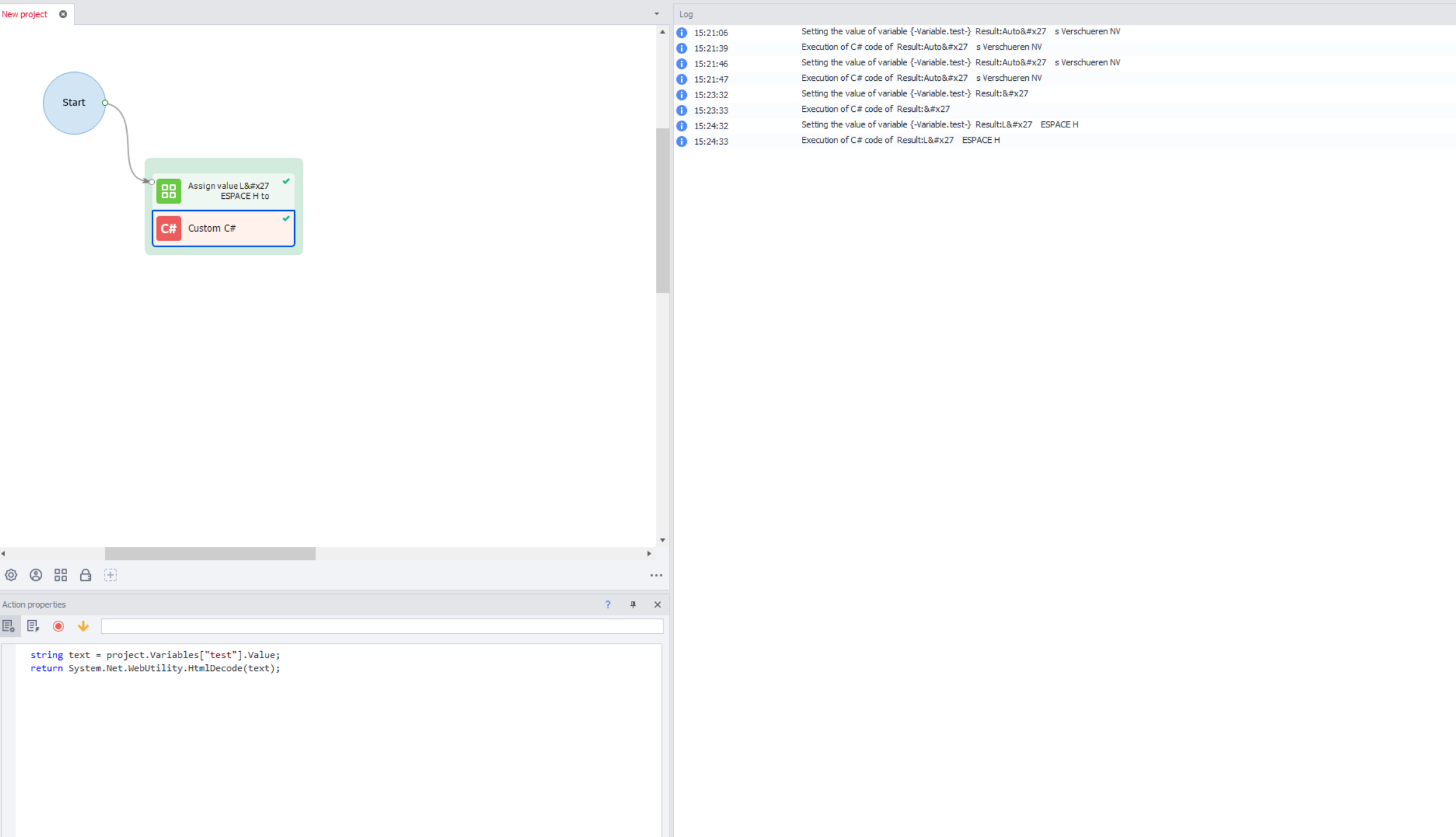

Thank you very much, I don't have any more errors with your script but I don't understand because the final value remains unchanged, was I in the wrong library?
The value returned remains unchanged

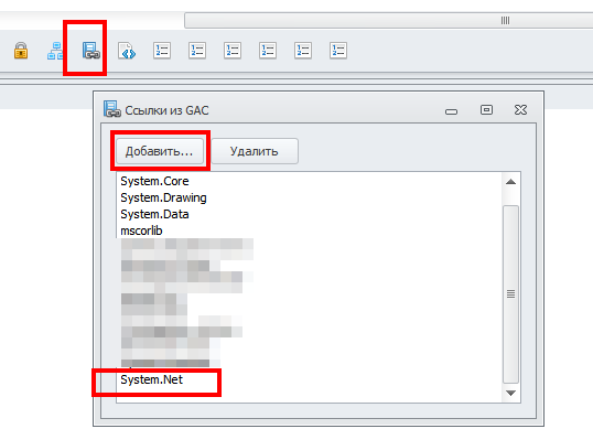

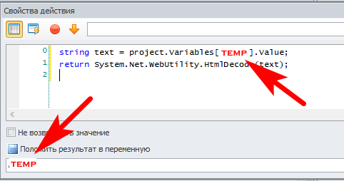

105521
I adapted the code, it should run correctly.
To return a value to a variable, you need to specify it.
But, I don't know if the WebUtility method does the transformation you need - I thought you know what it does, but don't know how to run it in Zennoposter.
