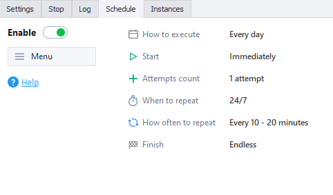

After updated to 7.2.0.0, Schedule have proble when i set a range hour in when to repeat. This is my setting.
64513
I want my project run affter ZP starting and it only run form 6am - 10pm then stop. Everything ok but until 7.2.0.0, it not run after ZP running. It choose a random time in the range to first start when i see time column NEXT RUN. I need to turn off and turn on schudule to make project run immediately.

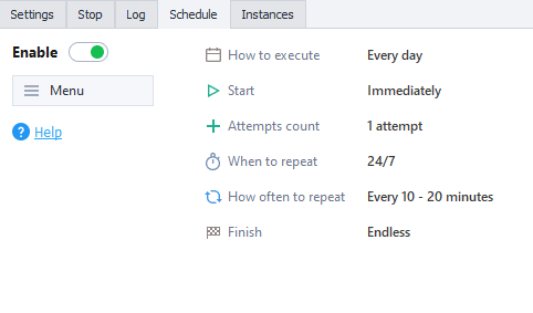

I set time becasue i want all project not working after 10.0pm. And it time i finish a day work, i dont want to wait any project finish to close ZP and turn off PC.

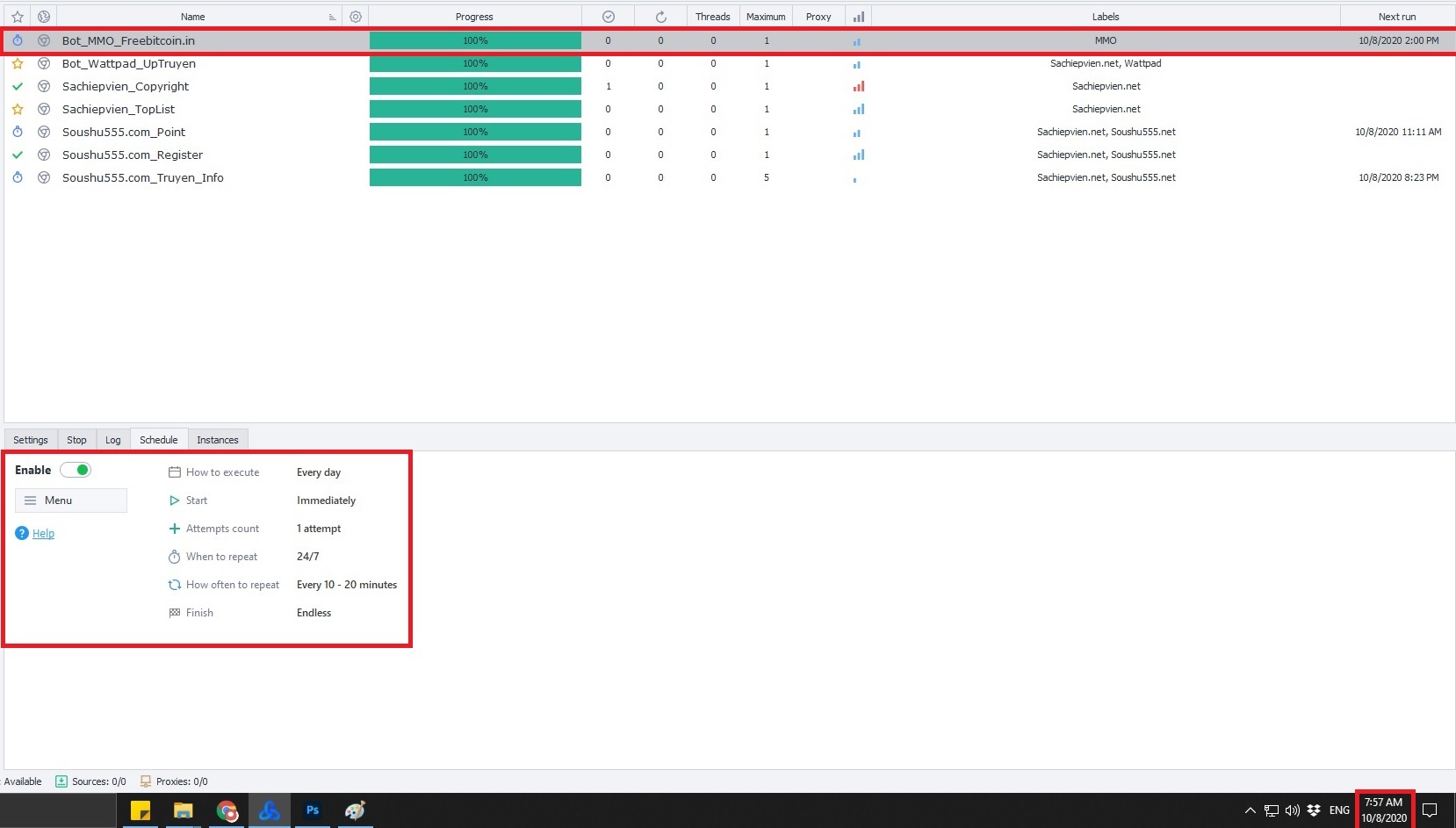

I tested a project with set 24/7 in schedule (imagine below). Sometime after i run ZP, ZP set time for first run after 2 - 3 hours (see in next run column), so i need restart schedule.
Then the bug is not that it does not start immediately. The bug is that next run is too late.
I checked but couldn't reproduce. Next run is within few minutes after running ZennoPoster.

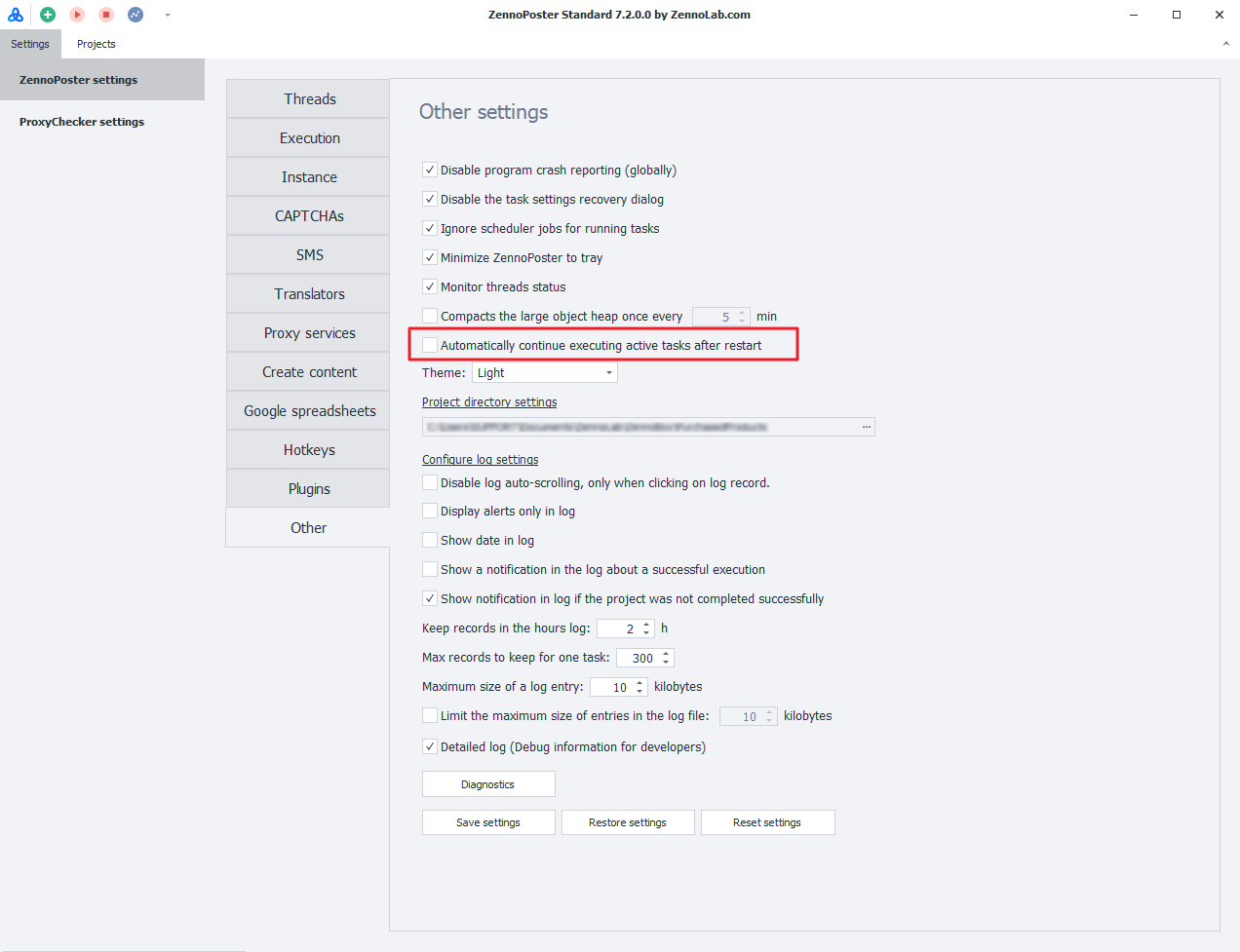

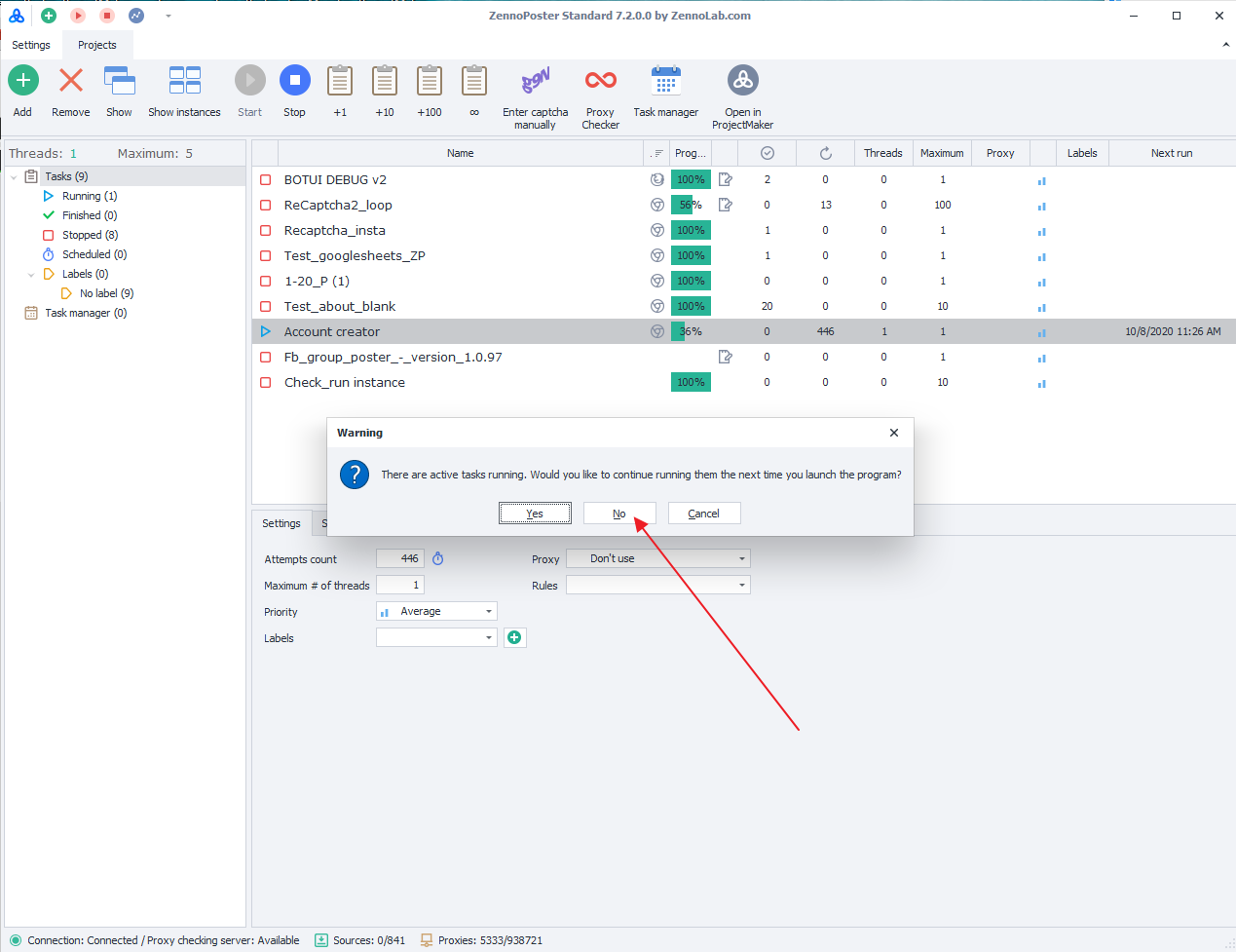

How long is your template executed? Do you choose to continue running task at next start when closing ZennoPoster?

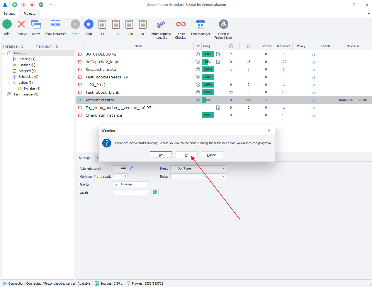

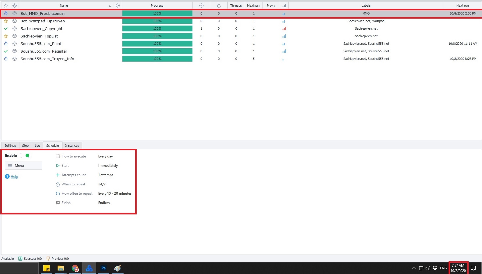

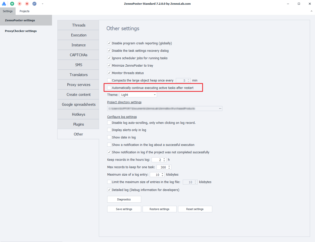

Tks for supporting. I found my problem. Seems like in ZP 7.2.0.0, i need to change all project 's status to stop before close ZP. If i close ZP when all project 's status is not stop, next day, after i run ZP, it will be like that:
65123
