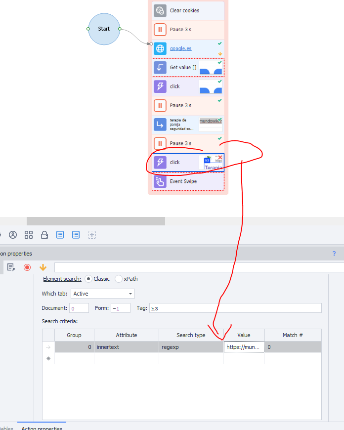

I am trying to create a template where putting a keyword in google will search for it in the browser.
So far I have it done
The doubt that I have is once the kw searches for it in the google search engine that variable I have to put to enter that url?
I tried to set a variable "CLICK" and I defined the url but it does not work.
How can I make it so that once I search in the serps, I can access the url I indicate?

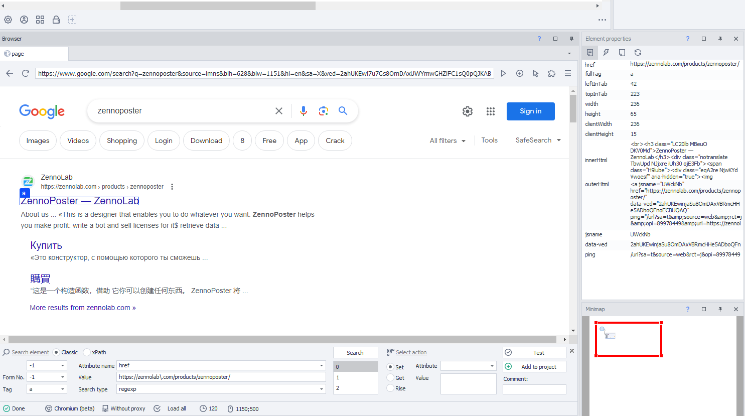

Hi. You have to find the exact element you wanna click by using action designer. Once you do that, you will see how your required url should look like in the value field. Then you should input urls in the same way. By the information you provided i can not tell what exact problem you have. As an example for zennoposter search query, it looks like this. While its not perfect search criteria, but it will work.

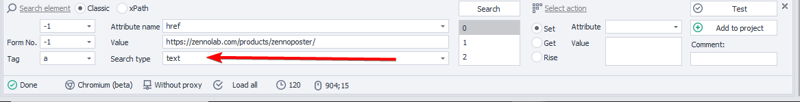

Pay attention to the url: https://zennolab\.com/products/zennoposter/ as you can see it with different \ char in the middle. That's because it's regex. Maybe thats your problem. Check. If you wanna without regex you have to change type to text.
