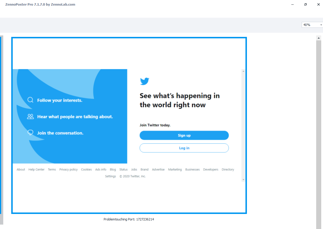

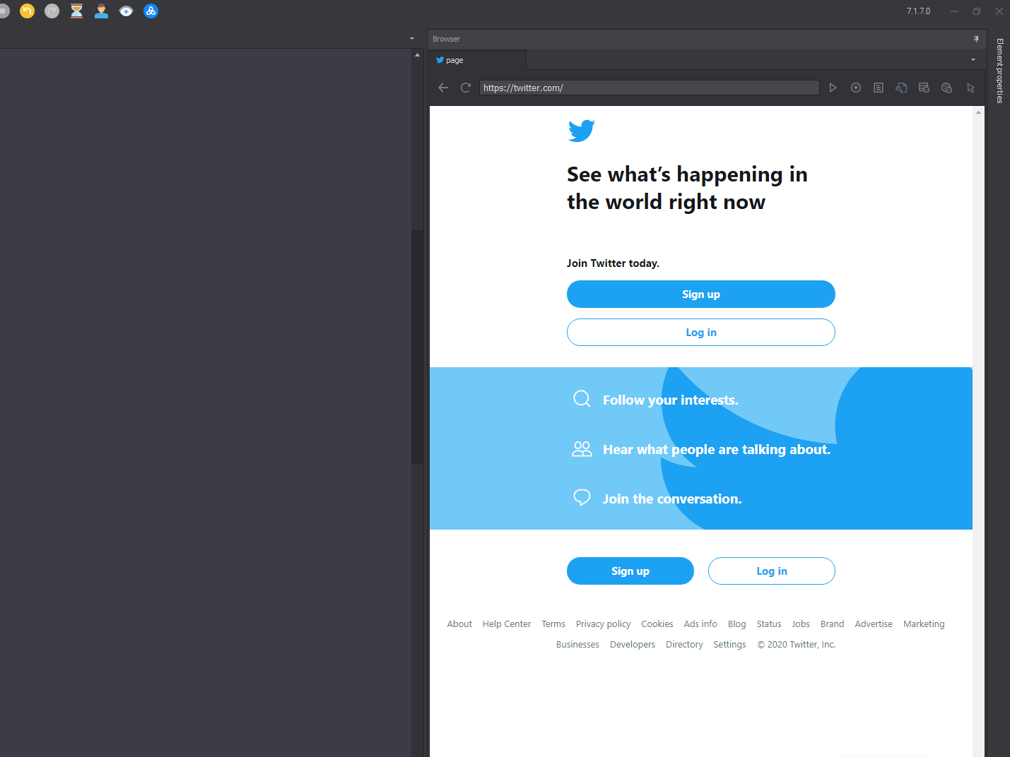

In PM I can see the browser FULL Height
and in ZP It only shows about 75% of it?
I'm getting Error Since Im using TOUCH Function and the element(button) is in the Bottom PART the TOUCH function can't see it.
My question is, how can I make ZP use the same HEIGHT as in PM?

but isnt this gonna be same screen size for every new profile? isn't that suspicious for other sites? like this FIXED screen size is registering accounts?
