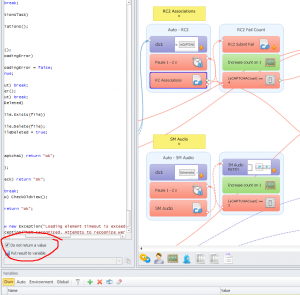

My "template" looks like this. I just need pretty simple template with google example. I'll do the rest.

Try selecting "Do not return a value"
It works for me

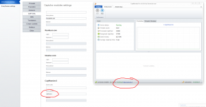

It works in ZennoPoster, but not in ProjectMaker. Any ideas?

I do not know how that can happen, all I did was make sure my CAPTCHA settings are the same on ZennoPoster and ProjectMaker
And then select "Do not return a value" in ProjectMaker
These settings worked for me. Look through CapMonster settings for other possible conflicts, like "Select IP-address automatically"
Also, running some programs at the same time can cause problems, even Skype. So close all other programs that you are not using, to see if they conflict.

Also, delete that last part, it is not going to work with ReCaptcha2. You only need the C# from the Zennolab wiki.

I checked "Do not return a value" and now it works fine with no error in ProjectMaker. Thank you.

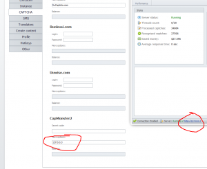

I'm having the "x" problem again. I don't know how this happens, because this template worked a few days ago.

It's not 4x2 problem. A few minutes ago 4x2 captcha worked fine and later 3x3 did not want to work again. It didn't work in ProjectMaker, neither ZennoPoster. Now after a few minutes it works again. Take a look at screenshots. Can anyone tell me what the heck is going on?

Sorry for late reply.. This one is quite simple.
Look at the Log.
CapMonster cannot recognize that specific image, maybe because it says "Click verify once there are none left." or maybe for another reason.
CapMonster also does not have 100% success rate with ReCaptcha2 images.
Solution
You have 3 options...
1) Send to service like 2Captcha, they do support ReCaptcha2 images and they do support "Click verify once there are none left."
2) Change to ReCaptcha2 Associations - http://zennolab.com/wiki/en:addons:capmonster:rc-associations
It has a much higher success rate than ReCaptcha2 images.
3) If you really do not want to change from RC2 images, then try putting in a "retry" loop
This is for when CapMonster cannot recognize the images, then it automatically clicks on the Retry icon
So your template will look something like...
Snippet for "Click Retry"
var tab = instance.ActiveTab;
var clickRetry = tab.FindElementByAttribute("div", "id", "recaptcha-reload-button", "regexp", 0);
clickRetry.Click();
Best to use that in a loop with a counter so that it does not get stuck in infinite loop...
That is all I can help you with.
