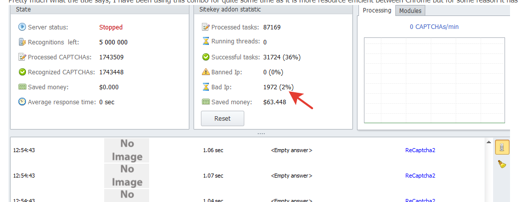

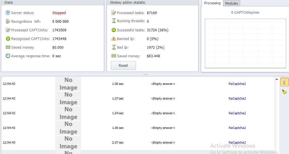

Pretty much what the title says, I have been using this combo for quite some time as it is more resource efficient between Chrome but for some reason it has started producing only <Empty answer>
105262
Any options that would resolve this, or perhaps a time frame for update in the software that would resolve this?
For the time being I will switch to Chrome, but it is significantly slower and more resource intensive on my server.
Currently on Capmonster Pro V2.13.16.0

Looks like httprequest method of solving does not work.
You should switch to Chrome method of solving recaptcha in sitekey addon settings.
Is there an estimated time for when there will be a fix for the httprequest method, it was the perfect solution because of how little resources it needed.

2.3.11 .0 does not work sadly same <Empty Answer> Response
Upon further inspection not even 2.13.5.0 work correctly, instead of <Empty Response> I do get responses with the photos, and the software does seem to try to identify what the photo contains but the final solution is just not registered resulting in bad IP bans and no actual solution to be created.
Tested with integrated/coldproxy, same result.
