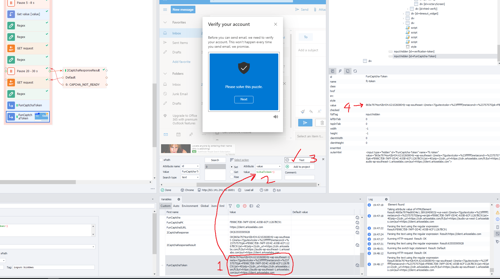

2Captcha's docs explain last steps:
5.) Locate the element with id fc-token and put the token into value of this element.
6.) Do the rest what you need to do on the website: submit a form or click on a button or something else.
I do step 5, and the captcha doesn't go away or show any indication as being solved. If I click the "x" in the top right corner of the captcha element and try to do the task that triggers the captcha, I get another captcha.

Hi Vlad,
Yes it was Capmonster with the issue. I did not realize 2captcha = rucaptcha so I disabled rucaptcha as well.
Once I made this fix, I am now able to successfully send the request and receive valid responses, but now I have a new issue.
I think you should perform step6 to actually submit tokes and finally solve the captcha.
I suppose captcha won't disappear or will be indicated as solved after that.
It will be verified as solved on website internally.
You should just continnue your work on a website after that
