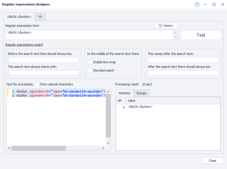

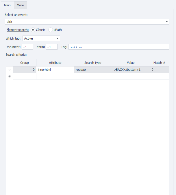

Is not regex by default case sensitive ?
Regex: >BACK</button>$
And it match:
1. <button _ngcontent-c9="" class="btn standard btn-secondary" type="button">BACK</button>
2. <button _ngcontent-c9="" class="btn standard btn-secondary" type="button">Back</button>

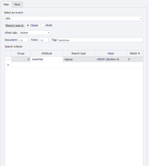

Need more details on how to reproduce it. Maybe you use C# for regex?

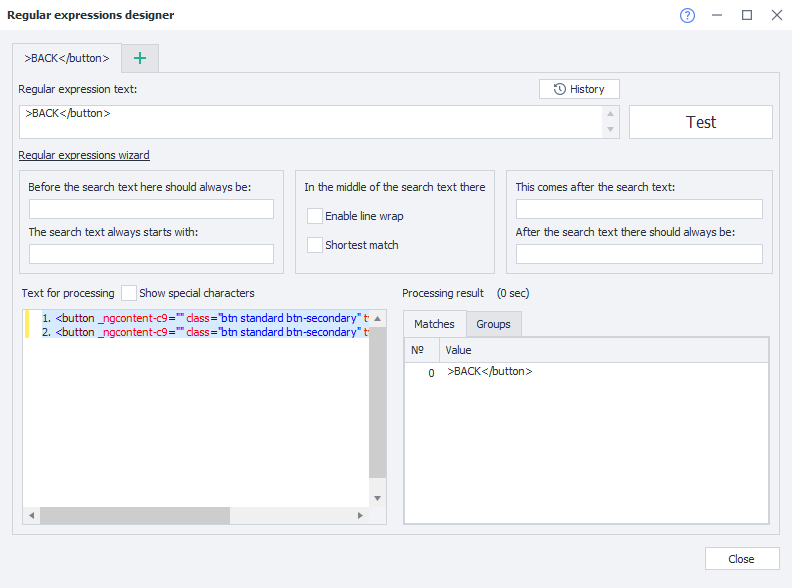

You can enable case sensitive again by prepending (?-i) to the regexp.
I am not sure that this is the good idea. Changing this behavior will break backward compatibility for all templates.
Regex should be case sensitive by default man, this is not my suggestion, but this is how regex should work in general.
nicanil
06.03.2016
2 247
1 836
I agree with you. But imagine how many projects have been created and changing regex behavior will break them. But that's only my opinion. Anyway, task was created and developers will think about it.
