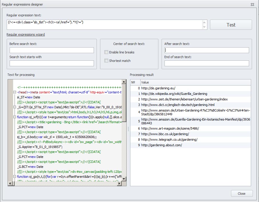

I try to scrape search engine results - the regex works in the regex designer but not if I do a testrun.
What is the problem?
Regex for bing: (?<=<div\ class="sb_tlst"><h3><a\ href=").*?(?=")
(-->Does work like a charm in the regex designer.)

Ok, some pictures here - regex works fine:
This is the short project:
As you can see I use the regex that works in the regex designer

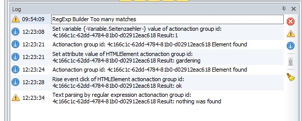

This is the error-log (ignore the first entry which was from another test some hours ago):
Where is the error? I use no proxy and the Bing SERP in the zenno projectmaker browser seems to be correct -there should be 10 results...
