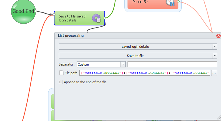

are you still able to prompt me if the GOOD END option can save used email and other data?

51962
after successful completion, no data appears in the file indicated for saving
Please be careful. Read what is written in action.
File path means you have to set a file path, not data to save.
Read more about lists: https://zennolab.com/wiki/en:list
You can also use forum search there will be many posts.
First, you add a list. then You bind list to file.
then You use action and save data in the list, which will automatically save data in the file.
