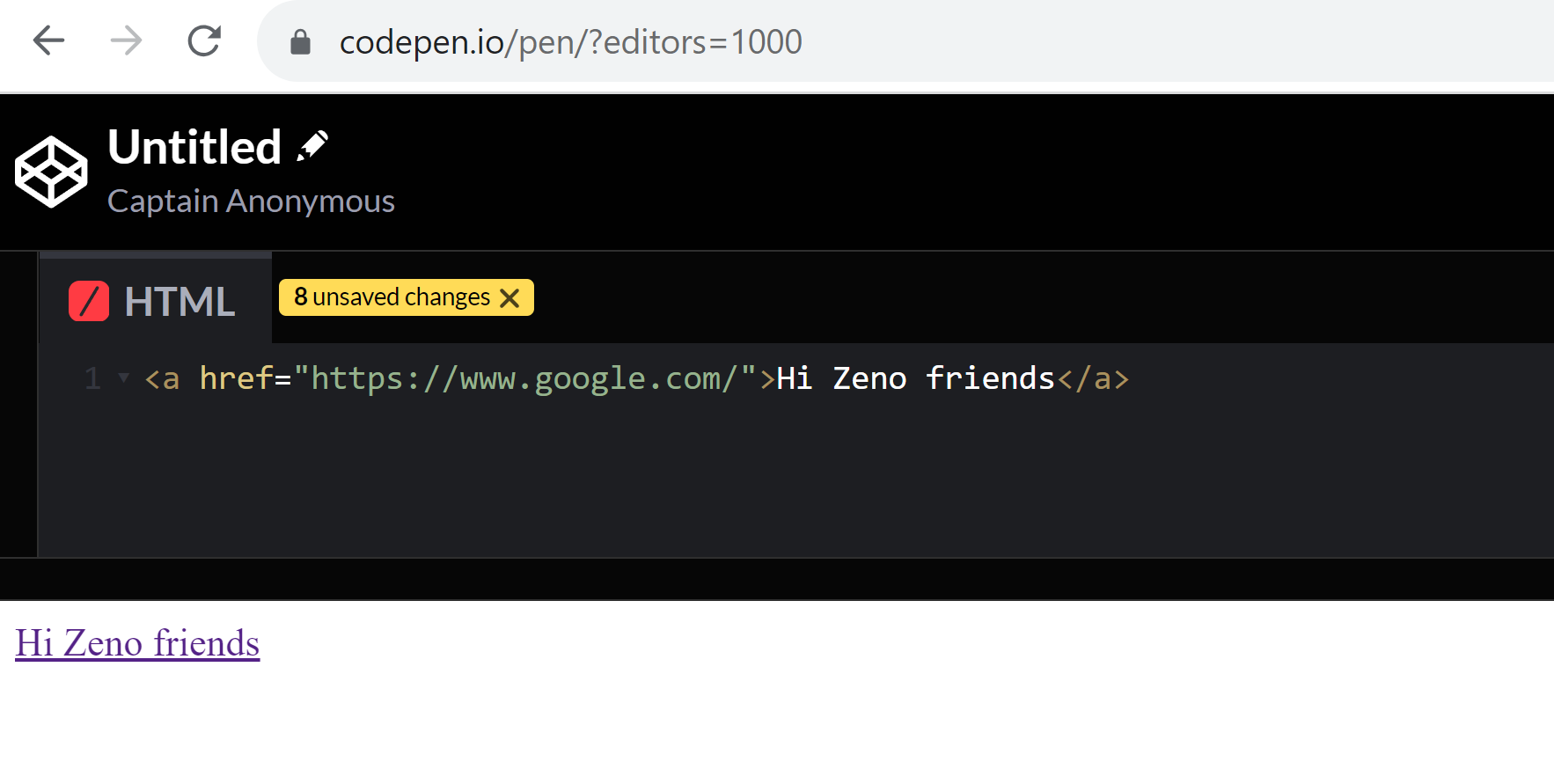

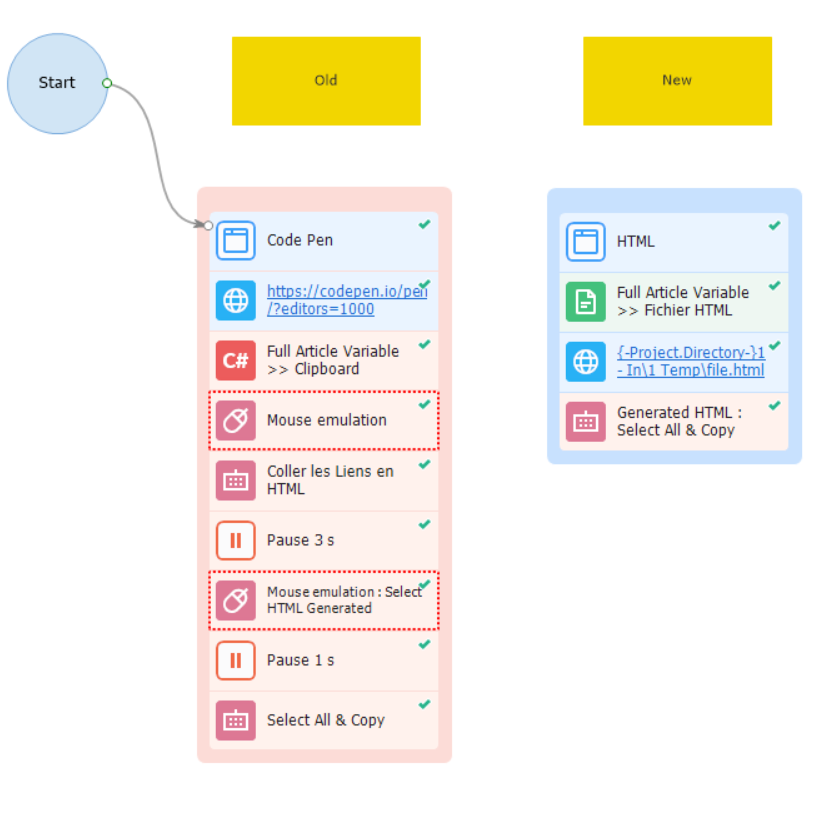

My current process involves generating HTML code, using CodePen to simulate text entry, copying, and then pasting it onto the target site to maintain formatting. This method, while effective, is not ideal for automation.

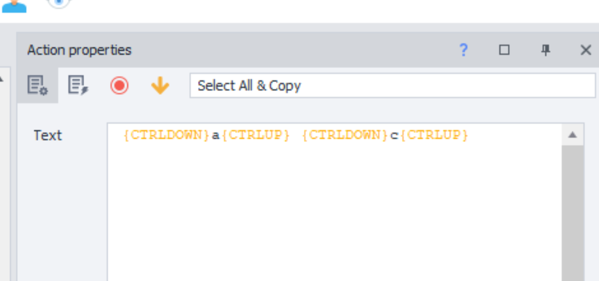

( i use mouse and keyboard simulation for this...)
I am currently transitioning directly from HTML to copying the rendered HTML for pasting on the site, an improvement from earlier methods. However, I am seeking a more elegant solution that bypasses external sites and fully automates this process in a cleaner manner.

Exemple of simulation just to copy the front end from copy pen... ( and before i do mouse simulation to select the area)
