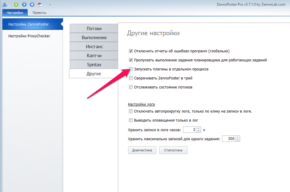

tested. muted by my side. what feed do you use? is flash enabled or disabled?
Cyrix
16.12.2011
393
Flash disabled. I have too many feeds. No idea which feed.
29 068
5 725
Mute will not work if this option is enabled
Otherwise example is needed
