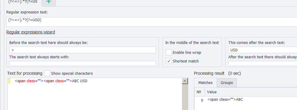

For example, for
<span class=""><span class="">ABC USD
I want to find the shortest match between ">" and "USD", the correct match should be ABC , but Regex Tester wrongly generated a Regex which returns
<span class="">ABC
84750
22 233
5 846
For example, for
<span class="">ABC
Shortest match works from what searched text begin with, not from what goes before searched text
You should specify what searched text begin with
for example - (?<=>)\w.*?(?=USD)

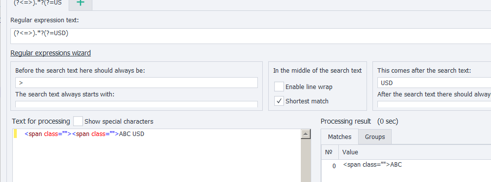

Cyrix
16.12.2011
390
The regex formula you provided was not what Regex Tester generated (which produced a wrong result), even when "begin with" was used.
84993
